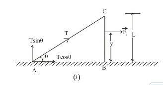

From the picture, take the moment about B. Find an equation for F_a
rFsin(theta)
Let r be some arbitrary distance.
rTsin(theta)-F(y) = Torque
Correct answer (I believe) is F_a = Tcos(theta)/ (y/L)
I have no idea how they got this. I thought Tcos(theta) went through the pivot point and hence had a torque of zero.

It does, but what about the torque from Tsin theta?? The distance 'r', depending on what you are defining as 'r', is not arbitrary. And the sum of the 2 torques must equal_____?

I believe you may have a misunderstanding as to how to calculate Torque.
There are 2 ways to calculate the torque (or also called moment) of a force or force component about a pivot point.
The first way is to calculate moment (M) is to break up the force into its x and y components, then sum the components of each Force (F) times the perpendicular distance (dperpendicular ) from the line of action the force to the pivot point.
(M = sum of F(dperpendicular), and watch plus and minus signs.
The 2nd way is M = r X F = (r)(F)(sin alpha), where r is the distance from the point of application of the force to the pivot point, and alpha is the angle in between F and r at the application point.
Note that the angle alpha in this equation is NOT thr angle theta given in the problem.
Use clockwise moments as minus, and counterclockwise moments as plus.

I trust you are not asking me to give the answer, but here are some tips:
You can use either approach.
Using the force time perpendicular method, then the moment about B is F_a(y) - (Tsin theta*(distance measured along the line AB). You'll have to do a bit of trig to calculate this distance. Note that the direction of Tsintheta and Tcostheta as shown in your figure, at point A, are, unfortunately, incorrect; they should point down and left, respectively.
Alternatively, using the r X F method, then the moment about B is F_a(y)(sin 90) - T(L) sin alpha, where alpha, as I defined earlier, is determined using the geometry of a right triangle.
Yes, but I don't get F_a = Tcos(theta)/ (y/L)
Please show your work and I can then see where your error might be.
