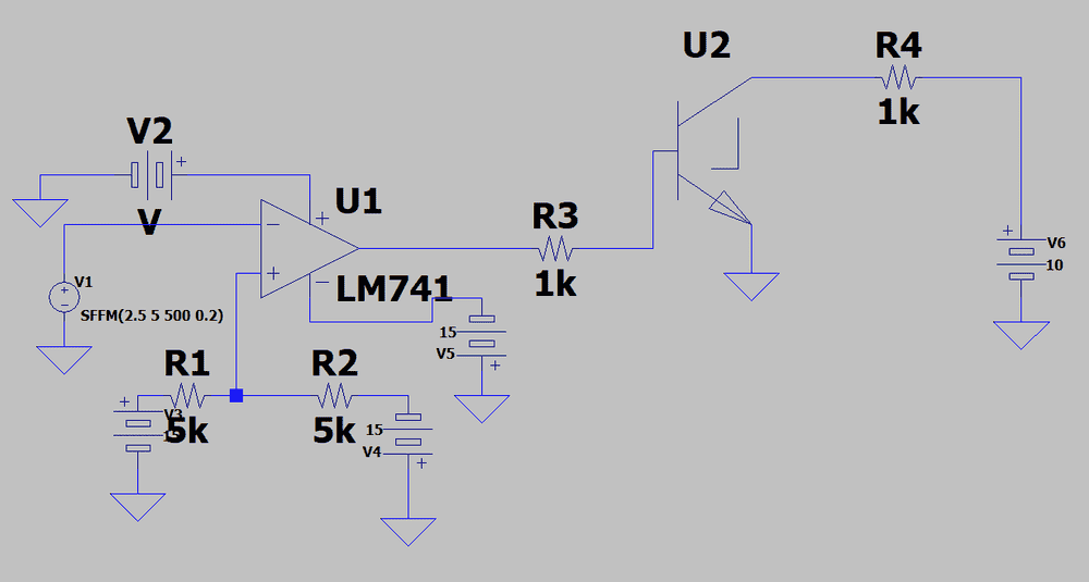

Simulate the circuit shown below sung LTspice.I tried to simulate it , but I didn't get the corrected result. Here's is my attempt:

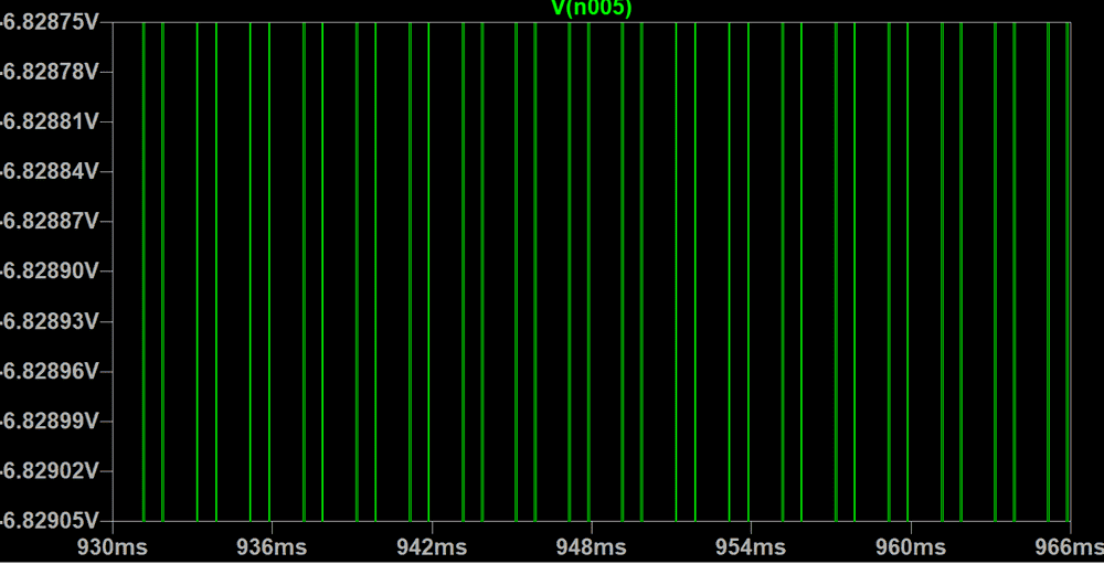

The result (voltage in the collector of the transistor) :
Could someone let me know where is my mistake?
This looks like a continuation of your previous thread using MultiSim:
https://www.physicsforums.com/threa...ep-down-chopper-using-multisim-matlab.988525/
First of all, this is not a "step-down chopper circuit", so I may end up fixing your thread title. You also never answered my question in your other thread about what function the opamp is serving in this circuit. It is not being used as an opamp, it is being used as a ______________. Please try to answer that question.
On your LTSpice circuit, there are a number of errors. First, the -15V voltage supply for the LM741 is connected to +15V. Please reverse that voltage supply so that the LM741 is running between +/-15V power supplies.
Second, you have 0V going into the "-" input of the 741, but the triangle wave generator going into the "+" input is ramping 0V to 5V, so the 741 will not trip. You need to offset the "-" input to somewhere in the middle of 0V to 5V if you want to see a tripping behavior to drive the output transistor.
Finally, it is not good practice to draw the wire to the "-" input as you have done. When the wire to the connection point runs along the body of the IC symbol like that, you can't be sure that the wire is reliably connected to the "-" input point of the opamp. Instead, draw the wire coming at a right angle out of the opamp triangle symbol (to the left) for a little ways, before you put in a right-angle bend in the wire to go down to the voltage supplies below.
Can you make those fixes and then show us what the quiescent voltages are for all of the nodes in the circuit before you turn on the triangle ramp generator? Thank you.

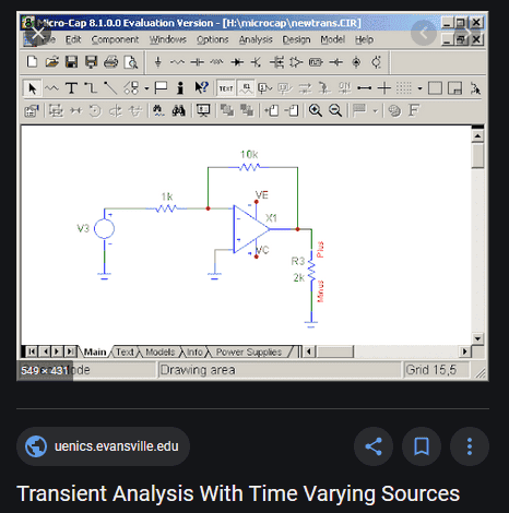

I don't think I've ever used a battery symbol in a Spice simulation, but I could be wrong. Hopefully LTSpice has traditional voltage source symbols available, like I use in Micro-Cap Spice software:
Yes, I think it does (I haven't used it in several years, though). Typically the battery symbol is a only a DC source, and the circular symbols are more complicated waveforms (or just DC, if you want). It's just a difference in style.

I tried to make the fixes you mentioned, but could you please explain further how to fix the third point ?
(V3 =15 V, V2=15V )
The result :
The circuit looks much better, thank you. :smile:
The key here is that the opamp is being used as a comparator, to compare the two input voltages from the voltage divider on the "+" input and the sawtooth waveform on the "-" input. As you move the reference voltage that you put into the "+" input by varying those two voltage sources, you will trip the comparator earlier or later on the rising ramp of the sawtooth waveform. That will give you a varying duty cycle on the "pulse width modulated" (PWM) output of the comparator.
Can you clarify what the numbers shown next to the V1 ramping supply symbol mean? I'm not sure they mean the same thing as in my Micro-Cap Spice program. Do they mean you are using a sawtooth ramp that goes from 2.5V to 5V? I think you used to have the ramp going between 0V and 5V -- either is fine, but you need to keep in mind that you will adjust the comparator input voltage to different places along that sawtooth input ramp to get different output duty cycles out of the comparator into the output transistor stage.

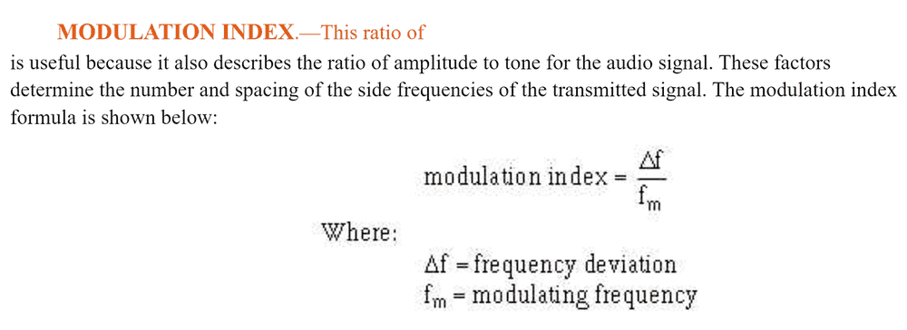

Interesting. What's a Modulation Index in this context?
Anyway, did you understand my comments about how the rising sawtooth waveform defines a pulsewidth for the output of the comparator circuit? I think that's what the homework problem is trying to guide you toward.
So how can you optimize setting the input comparator voltage and your sawtooth ramp voltage input to give you the ability to set this circuit between 0% and 100% PWM output? And can you figure out where to put a diode and smoothing capacitor on the tranistor output circucit to let you set the output voltage with your PWM control circuit? :wink:

I still don't understand the definition of "modulation index" in this context.
from http://electriciantraining.tpub.com/14184/css/Modulation-Index-101.htm :

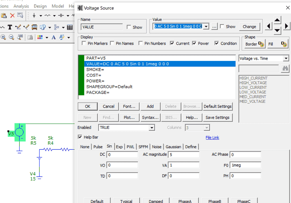

I tried to simulate using Spice, but how to determine I don't know how to determine the values of the ac voltage source, how to set the frequency , modulation index , . . .
Here's my attempt:
Could you please explain? I didn't use this software before.
Sorry, you now show a sine V5 AC source into one of the opamp inputs, but I thought this was supposed to be a PWM conversion circuit. You would need to use a sawtooth input into the comparator versus some DC comparison level in order to generate a PWM waveform.

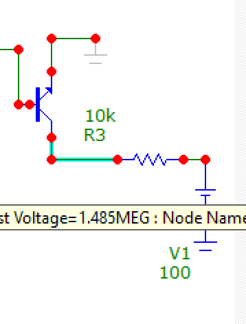

Also, it looks like there is a mistake grounding the base of the transistor? That needs to be deleted before the output transistor stage can toggle.

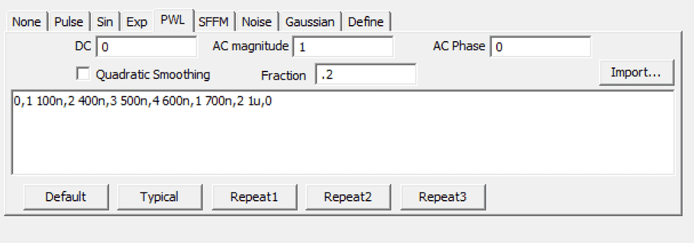

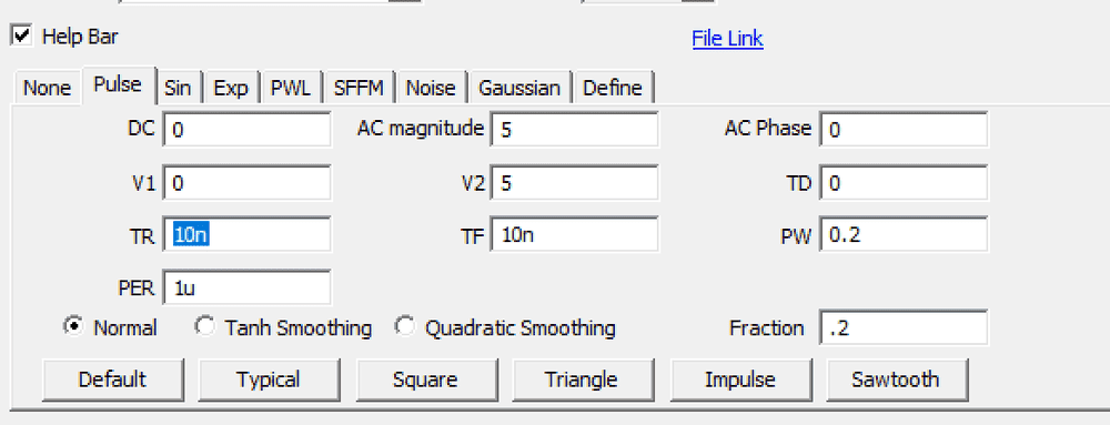

I didn't find a sawtooth waveform block in Spice , but I tried to get it using AC voltage source:
I sat the initial value of the voltage to 0,the pulsed voltage to 5 V and the pulse width to 0.2 ( 20%= 0.2 ).
How to determine the other values ?

Maybe set the TR (rise time) to something long to get a ramp? Try that and use an oscilloscope probe or plot to see what you get...
Normally in spice you would make a ramp by using the piece-wise linear definition of a voltage source. This feature allows you to build an arbitrary waveform by specifying points (voltage at a specific time) and the source will connect them with straight lines, these can be repeated at a defined frequency.

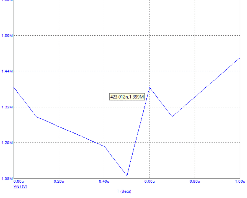

When TR is 10 sec.
The voltage waveform across this node is :
Are the other parameters correct ? or is there any mistake in the connections ?
The voltage parameters:
Here's what I got :
