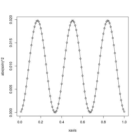

Here's an R-Code that forms the Hamiltonian matrix for the discretized square well problem and solves the eigenstate n=3 (the ground state is n=1), plotting the probability density as an output:
Code:
L <- 1                                               # Length of the domain
N <- 100                            # Number of discrete points
dx <- L/N
A = matrix(nrow = N, ncol = N)                # Hamiltonian matrix
n_state <- 3                        # Number of the eigenstate to be calculated
for(m in c(1:N))                    # Fill the Hamiltonian matrix with elements appropriate for an infinite square well problem
for(n in c(1:N))
A[m,n]=0
if(m == n) A[m,n] = 2/dx^2
if(m == n-1 || m == n+1) A[m,n]=-1/dx^2
v = eigen(A)                       # Solve the eigensystem
vec = v$vectors
soln = c(1:N)
xaxis = c(1:N)*L/N
for(m in c(1:N))
soln[m] = vec[m,n_state]               # Fill the vector "soln" with the wavefunction values
jpeg(file = "plot.jpg")                   # Plot the probability density
plot(xaxis,abs(soln)^2)
lines(xaxis,abs(soln)^2)
dev.off()
The plot that this code produces looks just like you'd expect from a square of a sine function.
Code:
dx <- L/N
for(n in c(1:N))
A[m,n]=0
vec = v$vectors
soln = c(1:N)
xaxis = c(1:N)*L/N
for(m in c(1:N))
dev.off()

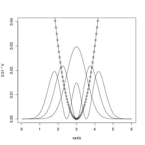

Yes, if for instance we have a harmonic oscillator potential ##V(x) \propto (x-x_0 )^2##, the discretized potential ##V_n = V(n\Delta x)## appears on the diagonal elements. My code that calculates the three lowest energy states of this system is below:
Code:
L <- 6.0                             # Length of the domain
N <- 150                    # Number of discrete points
dx <- L/N
V = c(1:N)
for(m in c(1:N))
V[m] = 3.0*(m*dx - 3.0)*(m*dx - 3.0)       # define a harmonic oscillator potential with spring constant k = 6
for(m in c(1:N))             # Fill the Hamiltonian matrix with elements appropriate for a harmonic oscillator system
for(n in c(1:N))
A[m,n]=0
if(m == n) A[m,n] = 2/dx^2 - V[m]
vec = v$vectors
psi1 = c(1:N)
psi2 = c(1:N)
psi3 = c(1:N)
xaxis = c(1:N)*L/N
for(m in c(1:N))
psi1[m] = vec[m,1]               # Fill the psi-vectors with the eigenfunction values
psi2[m] = vec[m,2]
psi3[m] = vec[m,3]
jpeg(file = "plot.jpg")             # Plot the probability densities for the ground state and two excited states above it
plot(xaxis, 0.01*V, ylim=c(0,0.04))
lines(xaxis, 0.01*V)
lines(xaxis,abs(psi1)^2)
lines(xaxis,abs(psi2)^2)
lines(xaxis,abs(psi3)^2)
dev.off()
A plot of V(x) and the approximate probability densities for quantum numbers n=0, n=1 and n=2 looks like this:
