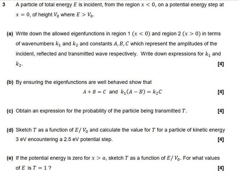

Please see attached image. I'm trying to do part (d), then (e) afterwards.
For (d) I can sketch the graph okay, just trying to calculate T now.
T= 4k1k2/(k1+k2)2
k = ((2m/ћ)2(E-V))½
I tried substituting in k into the equation for T. But k depends on the mass of the particle, which isn't given in the question. So what can I do here? I guess one option is just finding the point on the graph, but that's not really a calculation.
Look carefully at the equation for T after having substituted the equation for k.
When I subbed in k I hoped the m's would cancel but I couldn't get them to. Is it just some mistake I'm making - should they indeed cancel?
Thanks
It should. You have k's squared both at the numerator and the denominator.
Okay, I'll take another look at my working out. Thanks a million!
