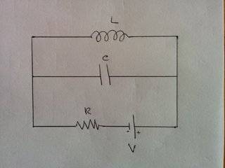

Take the following circuit (capacitor initially not charged) :

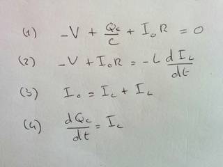

I am trying to solve for the current everywhere as a function of time. I set up the following equations (are they right ?) :
Then, any way I try it, I end up with some messy integrals. Even using wolfram alpha to get those integrals solutions, I can't find out I_0 (current in the bottom wire with the battery), I_C (current in the middle wire with the capacitor), and I_L (current in the upper wire with the inductor) as functions of time.
I suspect it shouldn't be that messy, I must miss something somewhere. Can anyone solve this for me?
I understand that :
- at first (t = 0, battery just plugged) the current must be 0 in the inductor (upper wire) and equal to VR in the middle and lower wires
- after a long time (t = infinity), current must be 0 in the capacitor (middle wire) and equal to VR in the inductor (upper wire) and in the resistance (lower wire)
What I am trying to understand is what happens in between t = 0 and t = infinity.

Now, sketch a model of the circuit and solve the transfer functions as for the currents, when the battery is connected.

It would help if you drew in the currents and labeled the potential drops across each element.
If you differentiate (1) and use (4), you get
$$\frac{dI_0}{dt} = \frac{1}{RC} I_C.$$ Then use (3) to eliminate ##I_C## to get
$$\frac{dI_0}{dt} = \frac{1}{RC} I_0 - \frac{1}{RC} I_L.$$ Rewriting (2) slightly gives
$$\frac{dI_L}{dt} = \frac VL - \frac RL I_0.$$ You can solve this system using matrix methods. Alternately, you can solve the bottom equation for ##I_0## and then substitute the result into the second equation to get a second-order differential equation for ##I_L##.

You can solve this system using matrix methods. Alternately, you can solve the bottom equation for I0I_0 and then substitute the result into the second equation to get a second-order differential equation for ILI_L.
Thanks. Sadly I don't know yet how to solve 2nd order differential equations. Do the matrix methods you refer need linear algebra? I don't know those as well. But nice to get the right equation to solve!
