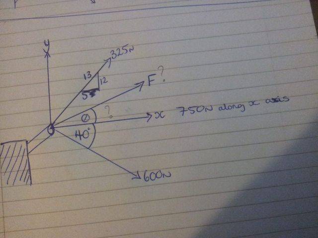

The question in short: If the resultant force acting on the bracket is 750N along the x positive axis, what is the magnitude of F and the direction (theta)
I have tried for several hours now trying to get this done. I have made a table for the components, Fx and Fy.
Fx
325cos(22.61) = 300.0215
600cos(40) = 459.62
Fy
325sin(22.61)=124.9483
-600sin(40) = -385.67
Rx = 759.6415
Ry = -260.6857
But I don't know where to go from there. In all honesty I really don't have much idea on what to do.
Please help me out. Thanks for your time for reading this!
Is 325N making an angle 22.61 degrees with the horizontal?
Oops. forgot to mention, I got 22.61degrees from the triangle on the 325N vector.
I got it by doing:
tan-1(5/12) = 22.6198

You need to write the complete question .It is not clear from the OP what are the given parameters .Please state clearly what is given in the question and if any picture is given in the question then attach the image .
Can you see the image?
Okay...
tan-1(5/12) is the angle which 325N force makes with the vertical not horizontal .
If a force P makes an angle θ with the horizontal then what are its components in x and y directions ?

Pcosθ for x component, and sin for y?
Yes...horizontal component is Pcosθ and vertical component is Psinθ.
If there are two forces P and R making angles θ and α respectively with the x axis,then the components of the resultant force ,T, in x and y direction (i.e Tx and Ty) will be
Tx = Pcosθ+Rcosα
Ty = Psinθ+Rsinα
i.e we algebraically add the x components to get the x-component of the resultant force .Similarly we do for y-components.

The only part which makes sense is where I have to add the x and y components to get the resultant of x and y. Where do I go from after I have the resultants?
This does tell you about the component of the resultant force in x and y direction . What do you infer ?
