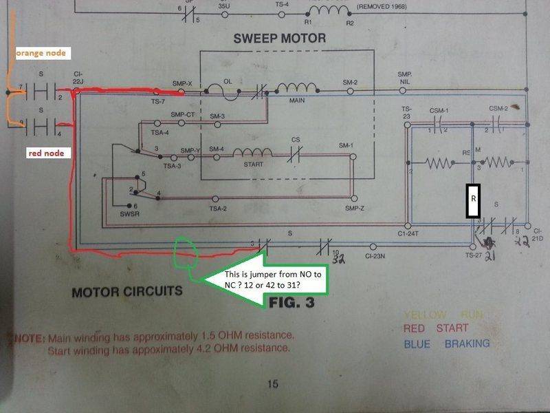

  • #241
jim hardy said:
If so, you seem to have fixed a contact race.
It's the jumper from 43 NO to the 31 NC of relay
  • #242
H012 said:
o put it simply, I fixed the contact race and took the 25 amps out of the braking NC'd I put to new cube relay in sweep we'll see if it changes anything. Does my idea sound OK to you?
If i understand where your new contact is, where i guessed it, that sounds fine. Great thinking !
What powers the timer's coil ?
My curiosity always wants to understand what was going on,
that's why I'm curious about what circuit drives the relay coil and just how sharp is its turn-off , ie how fast does it drive relay coil current to zero.

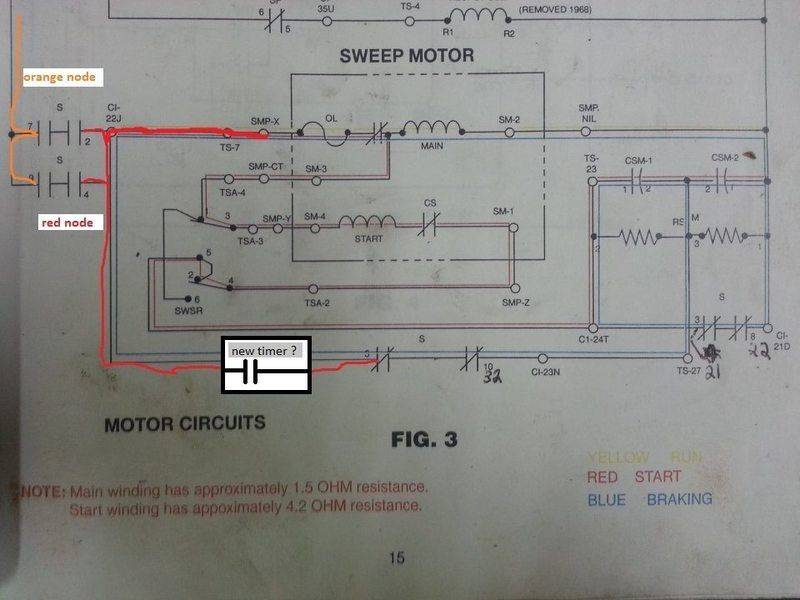

Trying to upload a picture. Having hard time
I just jumped from relay contact to timer contact.
  • #245
yes that looks right were you're indicating on attachment.
  • #246

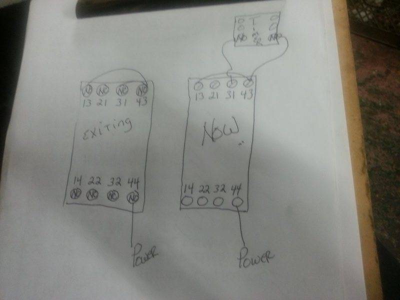

Finally got it to upload photo
  • #247
Hmmm at this moment it looks like you've broken up a relay contact race between one contact getting opened(the NC?) before other gets closed(the NO?).
Which makes one wonder why they paralleled two NO contacts in upper left on both Table and Sweep motors.
Do you think it could have been a desperate attempt to make them share load ? Like maybe they noticed arcing at factory prototype test time ?
why there's a race is speculation
and of course it was my speculation so I'm biased toward it
what powers your timer coil ?
What do you think ?

sharing the load maybe although that wouldn't be smart on their part as all the 115 power for the relays and other 115 V circuits in the chassis come off one common terminal strip. I've always wondered about it.
The timer coil is running to the sweep relay coil power. That way when relay closes the NO's on sweep relay the timer is set to wait until motor start circuit 25 amps is gone so that load isn't there on the NC when it opens.
Took awhile to figure start winding are engaged .05 sec which is what I have the delay set at. Hope I make sense. I tend to ramble on I think.

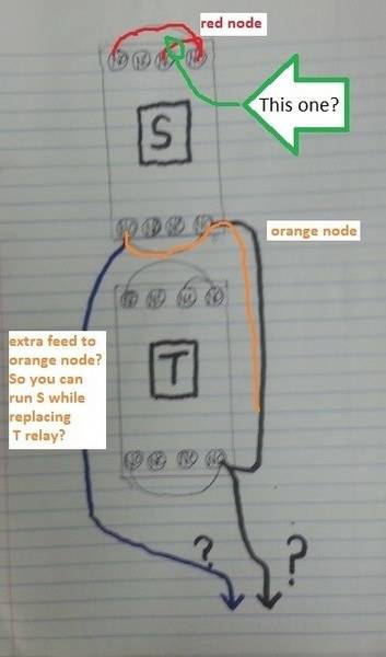

When nothing will show itself wrong you have to make everything show itself right. Check a relay for overlap.
Also we had way way back a question about an extra wire..
about post 127 or 128

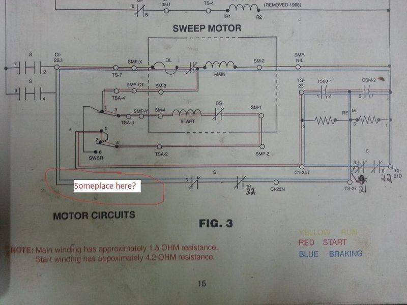

The 25 amps motor start exist at the NC opening when of course NO close due to a jumper from NO to NC. Yes there probably is an overlap but my thinking is that the 25 amps doesn't need to be at the NC's at all
Regardless of overlap. Also my thinking is that this time element that overlap occurs,
Is it enough to eliminate a chance of ionanation as the NC open? As far as checking the MOV I just checked continuity.
Tom/ Jim these are just my brain thinking trying to look at this as the sweep is running.
  • #256
Is that this one ?i can't keep those contact numbers straight
i can't keep those relay contact numbers straight.
Sure sounds like those contacts overlap for some reason. How does complete relay part number break down regarding overlap contacts? That AB bulletin is brutal to work through.

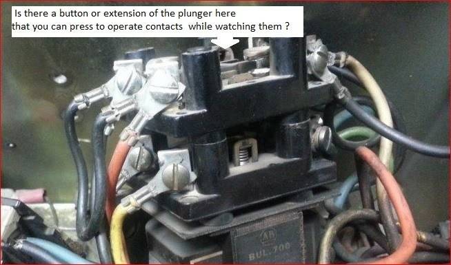

Used to be when i got this confused i'd sit down with a relay and the box it came in and the purchase order for it, cross check part number versus catalog number &purchase ordwr versus what the words say about contact operation and verify that by watching the contacts move as i depress the solenoid plunger. But that was in the power plant where everything was as over-documented as military gear. As you see fr some similar relays a simple 0 or 1 buried in the catalog number changes what you get from "Break Before Make" to "Make Before Break".
Sometimes the catalog number isn't on the part because it's made from subassemblies each bearing its own part number.
Is there a picture of the relay that melts its contacts someplace in this thread with a part number on it ? Do we know the complete catalog number that your parts guys are sending? Could they be off by that one digit ?
Did you ever watch the contacts while slowly depressing the solenoid button to see whether they're Break before Make or Make before Break ?

As stated before I used two meters one on NO and one on NC watched continuity. By watching I could not tell if make before break occurred. It happens too fast. I'm using analog meters. With the new relays you can't see the contacts. I have had all makes of relays the most common are the AB 700CF.
