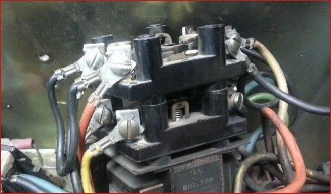

Tom/Jim Let me recap since it's been awhile since I posted that arc was gone. I took a chassis and put in cube relays so I could see if there was arcing. After I wrote that arcing was gone I pulled the cube relays out and put in the Allen Bradley CF 700 series relay. The other chassis has the WEG cwco16 contactor. Both these machines have the resistor and MOV in place. The AB relay is the one that went bad.

just to be sure which contact welded..
  • #214
https://www.physicsforums.com/attachments/106315
Positive on the one I stated

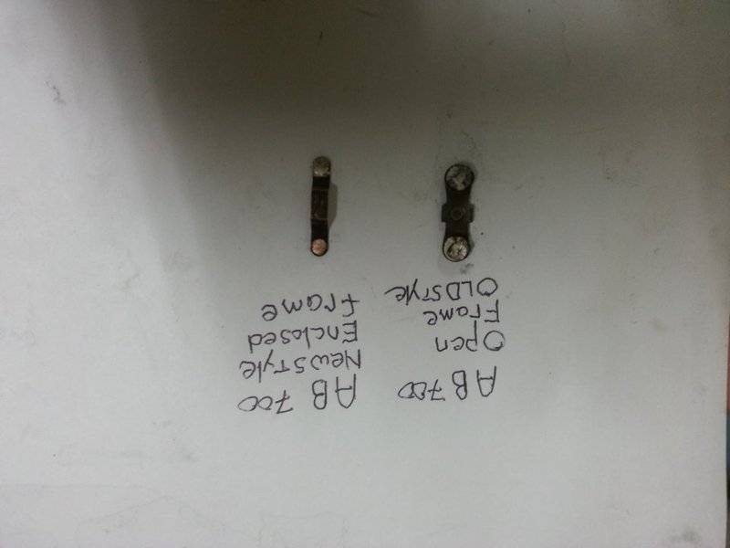

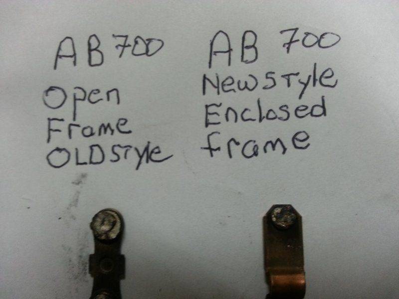

My thinking also I wanted to share the contact size difference both are AB 700 series just to show how quality has changed and that today's motor circuits have become more efficient so loads aren't as hard I suppose on the contacts

Here is a better pic

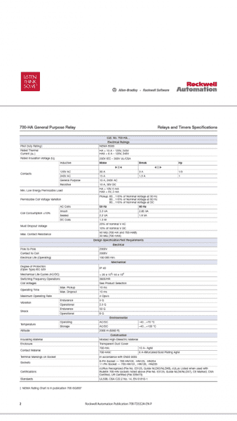

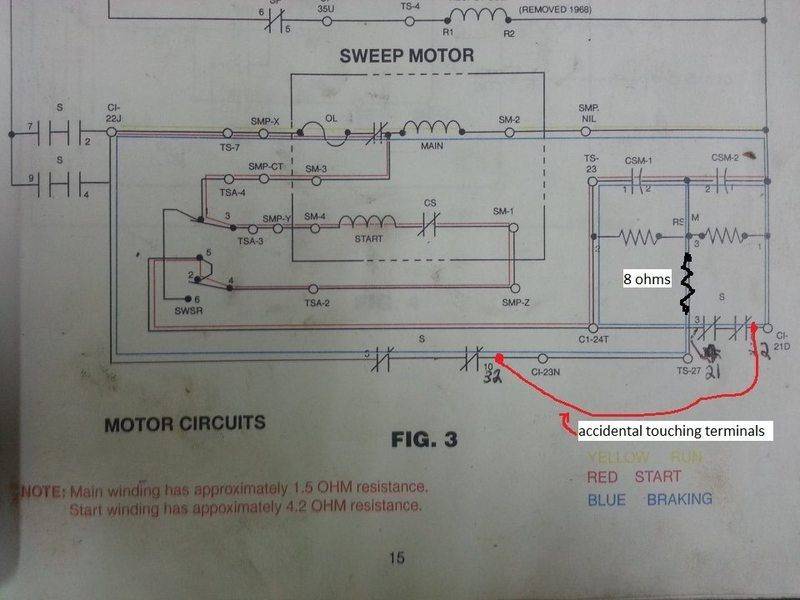

Where the blue line is where the resistor is. This is the spec sheet for the Allen Bradley relay and the other is for the CWC016 contactor.

Well this is how it goes when you can't get at it with test equipment, only way you know it's fixed is the test of time.Do i recall relays looking something like this ?
An accidental intermittent between contacts 22 and 32 (which i think are adjacent?) would bypass the 8 ohms we added...
was this machine a particularly bad actor before ?
during braking we have a tank circuit, motor run winding and the two start capacitors as shown by your blue trace. At resonance a tank circuit has current gain. Our 8 ohm resistor increases the damping but we don't know by how much.
You reported ( in post 23 ) measuring 29 amps someplace during braking. Can you measure current through the 8 ohm resistor on this machine during braking ?
Might give a clue, might not...
Contacts weld on make, just like when electric welding with a home buzzbox the rod sticks when it contacts the work...
When those contacts make motor dumps current into the capacitors . Welding can be quick. Presumably motor-cap combination passes through resonance as it slows down but if it's resonant during contact bounce millisecond , well...that's high current.
Sure need a hint at current through those contacts. Remember the 'thump test' ? Perhaps a coil with longer leads ...
surely the 8 ohms reduced your measured 29.
I will test again today to refresh. The 29 amps is motor start current which also goes the NC's via the jumper. The instant the NO close the start up current is at the NC's at the instant they open doesn't this cause a heavy arc?

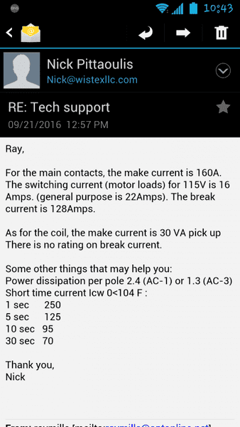

Well, that's the third model relay data sheet, AB 700 HA. You were using AB 700 CF.
The 700 CF is rated for twice the vibration and three times the shock resistance of the 700 HA, and a bit better than the CWC016. That could easily be the critical difference. Considering the harsh operating environment, I recommend sticking with the AB 700 CF relay, at least for now. That will reduce the contact bounce. Once they are proven to work well (or not), you can try other replacement options.
Thanks Tom How did you come across data sheet for the cf model when I went to AB site the HA is what kept coming up. I was going to do some test on the start switch to see if I could tell how long it stays in the reason here is that these motors had centrifugal switches originally which worked by rpm the new switches are load detecting Solid State.

I'm going to take a picture of motor so I can show you guys something. I'm glad you guys can understand the data sheets because a lot of it I don't. The vendor for the relays have been jumping all over offering different relays maybe a supply/price problem but it's frustrating. I own my own have been trying to find a contactor more suited for the 120 vac and current but the draw back is the 4PST with 2no& 2 NC don't offer very high current limits in the area that is needed.If I was using 208 vac and only needed NO these are limitless.

that's the relay contact race. I think they are break before make so NC should be open before NO closes. If you can see the contacts you can verify by taking relay in hand and operating the plunger slowly while you watch. Never should both be made at same time. Try it in several different positions, if it's close enough to be sensitive to gravity there's something not right. I can't recall whether those had a specified mounting plane.
I;ve found a lot of intermittents over the years from abraded insulation.
Our old Westinghouse BF relays were susceptible to debris falling down into the contacts.
The question to be answered is "There's enough current flowing to hurt those contacts. Where does it go ? "
It'd be nice to know how much it is. Surely those start capacitors will absorb a lot, and we thought we'd limited that with the 8 ohm resistor. Maybe we need fifteen or twenty ? The subtransient motor current can have fast rise time, rising while contacts are still bouncing which is deadly.
If that current is going where it's supposed to we attack its amplitude. If it's going someplace we don't expect , we work on that.
Looks like the NO contacts constrain it to where we expect, on paper.

..this is the HA ? from AB bulletin 700, page 2

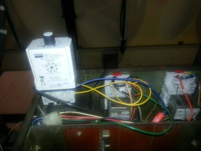

Ok been awhile. What I did was add a timer in between jumper wire from 43 to 31NC used the NO of timer at .05 secs. It closes after start windings have deenergized.Before if you remember There was 25 amps going through NC also as they were opening. Now by delaying the timer closes after the 25 amp draw has stopped. Now I only have 6 amps at any time going to NC's
  • #237
Refresh my memory
where's 43 and 41 ?
  • #238
If so, you seem to have fixed a contact race.

To put it simply, I fixed the contact race and took the 25 amps out of the braking NC'd I put to new cube relay in sweep we'll see if it changes anything. Does my idea sound OK to you?
