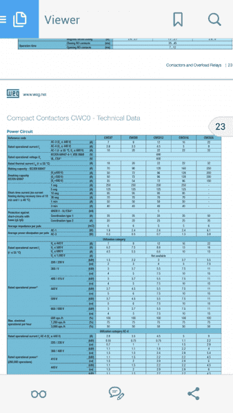

I will look up make current. The contact melted.MOV is OK at motor
  • #208
Tom.G said:
I think so, that's where all the problems were.30 Amps Make
3 Amps Break
Data sheet says make capacity ( A) 160

Check this out for spec. On this relay
  • #210
The image is not readable and it doesn't seem to be the Allen-Bradley that was used earlier. Can you give a link to the manual or tell us the make and model No. of the relay?
