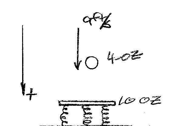

by the way would this problem be done in the same way?
4oz ball @ 9ft/s strikes a 10oz plate on springs with no loss of energy. find Vel. of ball after hitting plate, force exerted by ball on plate.
Yes, it's the same idea except that in this case you have energy conservation (elastic collision). The ball bounces off the plate. You have the same issue with the force. All you can do is find the total impulse because you cannot know the time or F(t) involved.
