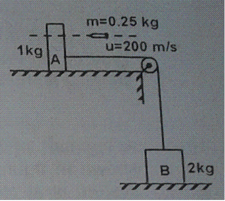

A block A of mass MA = 1 kg is kept on a smooth horizontal surface and attached by a light thread to another block B of mass MB=2 kg .Block B is resting on ground and thread and pulley are massless and frictionless.A bullet of mass m 0.25 kg moving horizontally with velocity of u=200m/s penetrates through the block and comes out with a velocity of 100m/s.Find the height through which the block B will rise.
Ans :5.21m
When bullet penetrates through block A ,an impulsive force P acts on it.
∫Pdt = 0.25(200-100) = 25Ns
Considering block A,let the impulsive tension be T
∫Pdt - ∫Tdt = 1(vA)
Considering block B ,
∫Tdt = 2vB
I guess I am missing something ,is it vA = vB because of inextensibility of the string connecting the masses? But that doesn't give correct answer .
I would be grateful if somebody could help me with the problem.

The speed of both blocks must be equal. You can assume that the bullet penetrates through the block so fast that you can ignore any displacements of the blocks during that time. But you know their speed from conservation of momentum. And then it is a decelerating motion...

There can be different approximations. I assumed that both blocks make a system that gets common speed from the bullet. I do not understand your impulsive tensions.

Momentum is not conserved in this problem . Please refer my attempt in the OP .From that you will get v = 25/3 m/s .
Tanya Sharma said:
How does the bullet give the blocks a common speed ?
It must be assumed that the thread is inextensible . It doesn't stretch !

I treated it pretty much like an inelastic (not perfectly inelastic) collision of a 0.25 kg bullet (That's one MASSIVE bullet) with a 3 kg object, then used conservation of energy with PE based on the 2 kg block.
I came up with 5.31 m .
They assume that the bullet collides with the system of the two blocks, as a whole.
I mean, this way you get their result.
If you look at a more realistic scenarios, it is not even necessary that the bloc B rise from the ground. If block A is long and "soft", so that the bullet looses momentum slowly, the tension in the spring may be always less than the weight of B. At least in principle.
Maybe we can solve a scenario assuming a constant force between bullet and bloc A and an elastic string, to study more interesting/realistic versions of the problem.
Edit. Sammy already posted along the lines of my first paragraph. I've got 5.21 m though.

If the string is always taut and inextensible, yes, the masses move together after the impulsive force does not act any more.
Try to solve the problem with a spring instead of string. Assume a massless spring, and Hook's Law valid. Assume constant force F for a very short time Δt. Both masses in rest initially. You can solve this problem.
You will get that A will move and B stays in rest at the beginning of the impulsive action. There will be an oscillatory term in the motion. But this oscillation ceases sooner or later as there is always some internal friction in the spring.

For inextensible string, vB cannot be less than vA.
The inextensble string allows for vB > vA but then the tension is zero.
So as long as there is tension in the string, the two speed must be equal. If we start with zero initial velocity of B, the tension accelerates B, so we must have some non-zero tension at least for a while. So that means they have the same speed for a while and then they must have the same acceleration (otherwise they will not have same speed over a finite interval). And if they have the same acceleration...
So again, if you want to get a more realistic image (and understanding), you need to drop "inextensible", as it was already suggested several times.:smile:
Then you can have different speeds and nonzero tension.
