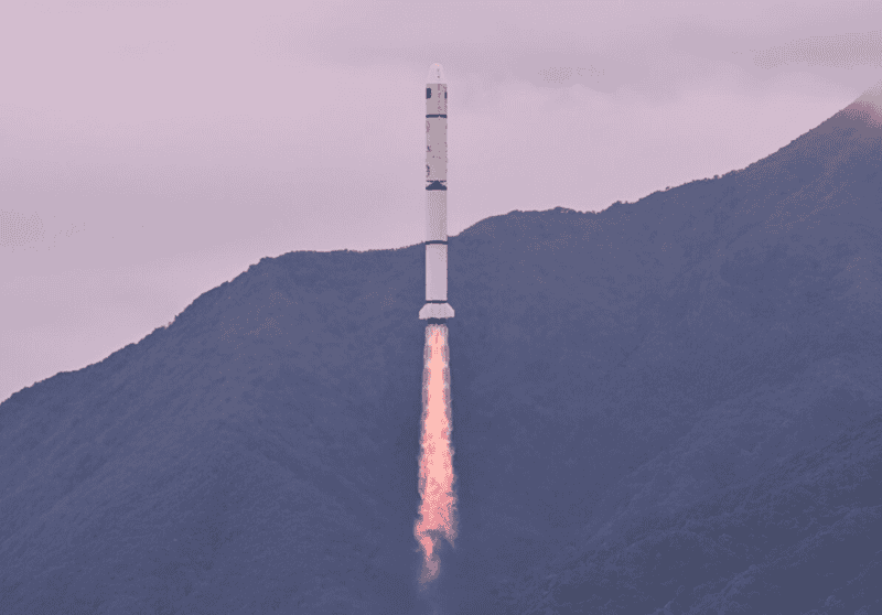

https://nz.news.yahoo.com/suspected-chinese-rocket-debris-seen-094454719.html
Markus Schiller, a rocket expert and associate senior researcher at the Stockholm International Peace Research Institute, said the debris appeared to be the first-stage booster of the Long March 2C rocket, which uses a liquid propellant consisting of nitrogen tetroxide and unsymmetrical dimethylhydrazine (UDMH).
“This combination always creates these orange smoke trails. It’s extremely toxic and carcinogenic,” Schiller said. “Every living being that inhales that stuff will have a hard time in the near future,” he added.

Ahhhh, yes, the Long Range BFRC Dispenser. 😆
Hydrazine, which is colorless but has something of a fish smell from what I’ve been told, will kill you on the spot.
The Dinitrogen Tetroxide is the brownish red plume and is able to break down into two nitrogen dioxide, which is the brown component of classic smog. It’s also nasty as it will attack your lungs, and if you get a good lungful of the stuff it’ll kill you in your sleep from your lungs filling with fluid.
Either way, fun stuff. 🙃

I would not have posted it if I had seen Nsaspook's information first.
It is on now, so at there is some info on dangerous rocket propellants and launch location strategies in the East and West.
Basically, if the launch photos from China have mountains in the background, you’re guaranteed to hear about the booster(s) crashing back down somewhere near a village. The location was chosen for security and logistics purposes, not downrange safety.
+1
I hope the local folk are all OK (including the cleanup crews) from this latest incident of many in the past.
