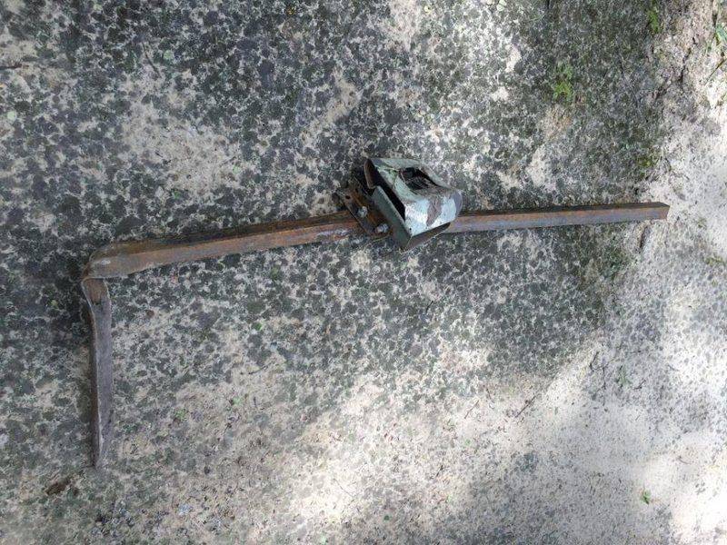

I have camera traps out on the African bush, that are monitoring the responses of leopards to artificial scents. The cameras are in steel boxes to protect them from elephants, the boxes are bolted to brackets 150 mm long and the brackets are bolted to steel poles at a height of either 500 or 700 mm above ground level. The poles are 40 x 40 mm mild steel angle, either 2mm or 3mm thickness. The poles are driven deeply into the ground. The mechanical problem is that elephants push the cameras over; they bend the 2 mm thick angle through 90 degrees at ground level, or twist it through 180 degrees. They bend the 3 mm thickness through 45 degrees.
I have videos from the cameras as they are being wrenched around and most of the work is done by the elephants’ trunks, with some kicking and stamping once the pole is bent over. Elephants are alleged to be able to lift 350 kg with their trunks. How hard the they can kick is an open question.
So my question is; what size and gauge angle iron or square tube would I need for a pole that could withstand twisting when 350 kg is applied sideways to a 150 mm lever bolted at right angles to the pole, without exceeding its elastic limit (camera aim is critical so the pole needs to recover after an elephant has tried to bend it) . And, similarly, what pole, standing 1 m out of the ground, could withstand being pushed at the top by an elephant – say 500 kg sustained force.

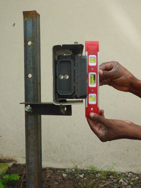

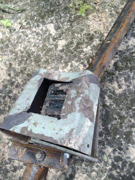

Here is a picture of the camera mount. This shows only the back of the camera box, when the cameras are in the field they are enclosed in steel.

I did not insert the picture correctly - I just cut and pasted. I'll try again with the upload button. SUCCESS !
A hand holding a red spirit level against a black weatherproof camera housing mounted on a rusty steel pole in front of a beige wall, with a bolted bracket and grass at the base.

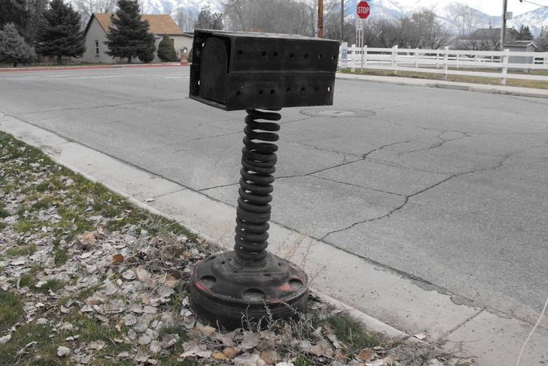

What if you used helical springs like what's used on some childrens playground toys and enclose your camera in a cylnder-like object attached to the springs?
The elephant can hit it or push it and it will pop back up.
Photo of a black metal box mounted on a tall coiled spring above a black circular base, set on a grassy verge beside a road with a stop sign and white fence behind.

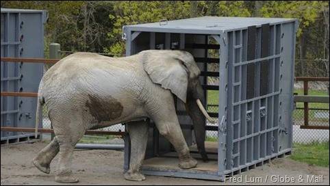

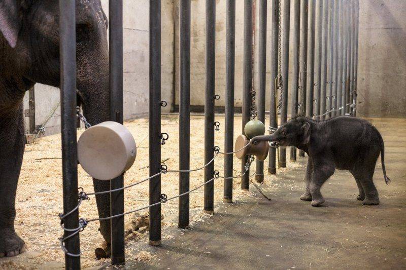

Perhaps you can get some ideas from circus elephant cages.
But I don't see how a cage, or a strong pole in the ground solves the problem of being moved or knocked over by the attack.
An African elephant walking into a grey steel transport crate with open bars, a photo credited to Fred Lum / Globe & Mail, with a wire fence and trees behind.

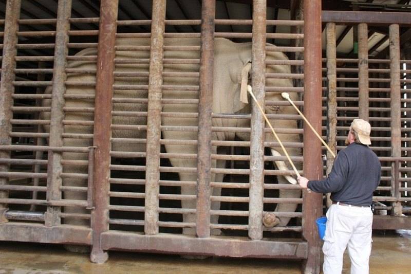

Photo of an elephant enclosure with vertical steel pipes and horizontal wire cables, a young elephant reaching its trunk toward a hanging object, and an adult elephant at the left edge.
A man in a cap and dark long-sleeved shirt uses a long-handled brush to wash an elephant standing inside a steel-barred pen with a concrete floor; a blue bucket hangs nearby.

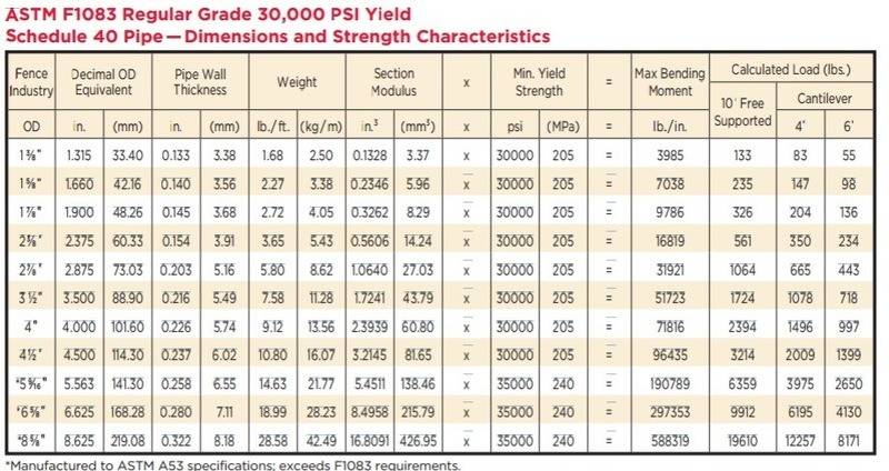

I presume that the tubes seen in these cages were cheap galvanized pipe. Here's a table with some strength numbers. The cantilever is closest to the case of a pole stuck in the ground. But don't forget that the bracket to hold the camera and the camera case itself can be the weakest link in the chain.
Table of ASTM F1083 Schedule 40 steel pipe dimensions and strength: OD, wall thickness, weight, section modulus, yield strength, max bending moment, and calculated free-supported and cantilever loads for 1-5/8 to 8-5/8 inch sizes.

Black metal mailbox mounted on top of a tall coil spring that rises from a round black base at the curb, with a stop sign and white fence in the background.
I tried that with coil springs from a vehicle. The two main problems are that if an elephant pushes one down with its foot and then steps off it, it will whip upright and probably inflict some damage, and that it needs some damping to stop it jiggling around for several minutes after it has been displaced and released. A heavily over-engineered solution would be an industrial strength door closer that can move on more than one axis.
An African elephant walking into a large grey steel transport crate with open mesh sides, on a dirt enclosure with fencing and trees behind it.
Photo of a baby elephant reaching its trunk through a barrier of vertical steel poles toward a larger adult elephant on the left, with white and green plastic discs mounted on wire between the poles.
A man in a cap and dark shirt uses long-handled brushes to wash an elephant held in a steel-bar pen with rusted vertical posts and horizontal rails; a blue bucket sits near his feet.
The crush cage at the top is proper structural steel, the vertical bars with the mother and baby are probably solid rod and will be anchored top and bottom, I suspect that the the rusty old iron at the bottom is drill casing, which has thick walls.
What I need is for one of you engineers to translate that table into the dimensions of a pipe in cantilever loading that will not go outside its elastic limit when carrying a 500 kg mass 1m from its fixed point. I need to use square tube or angle to resist rotation in the ground (a round tube will just rotate) and to provide a flat surface for the bracket to bear on.
