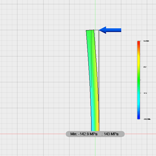

I did a sample case just to see what the magnitude of the problem is .
Simple cantilever / Hollow square steel tube / 1000 mm high / 75 mm across flats / 5 mm wall thickness / Mild steel / 4000 N horizontal load at top
That gives a safety factor of about 1.45 on yield for maximum fibre stress .

  • #35
Great ! That's what I've been looking for. That is a much heavier pole than I had thought, though not entirely impractical. Hammering it into the ground will be a mission though ! Would you mind looking at what load a 50 x 50 x 3mm square tube could recover from under the same conditions. I already know that I can get 50 x 50 mm into the ground without machinery. Thanks again.

Problem with more slender poles will be deflection .
For the 50 mm square tube you mention a load of 1100 N will give same SF but top deflection now > 8 mm .

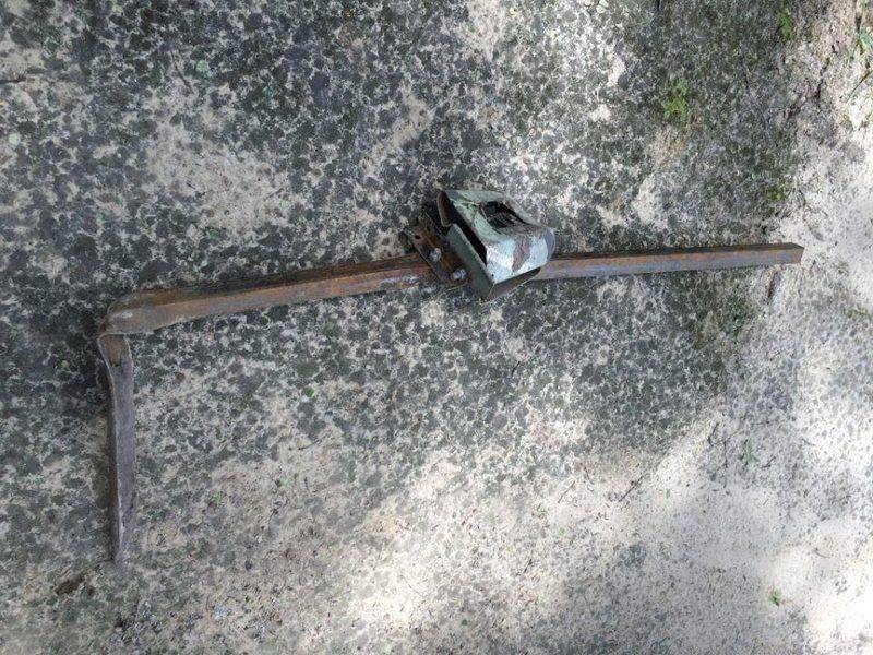

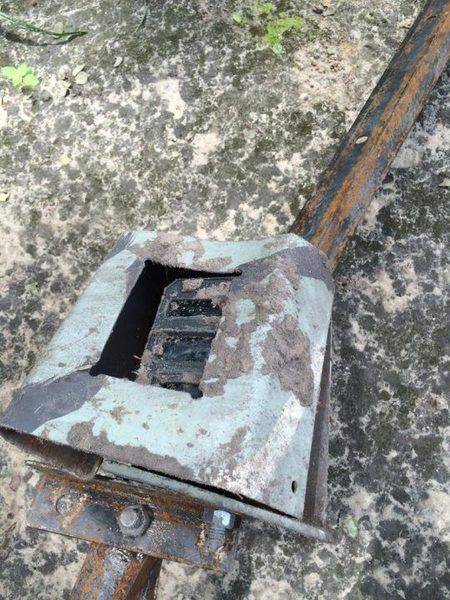

Snapshot Serengeti https://www.snapshotserengeti.org/#/home put cameras on 75x75 mm poles for a long-term fixed point survey. I will contact them to find out how they got them into the ground.
