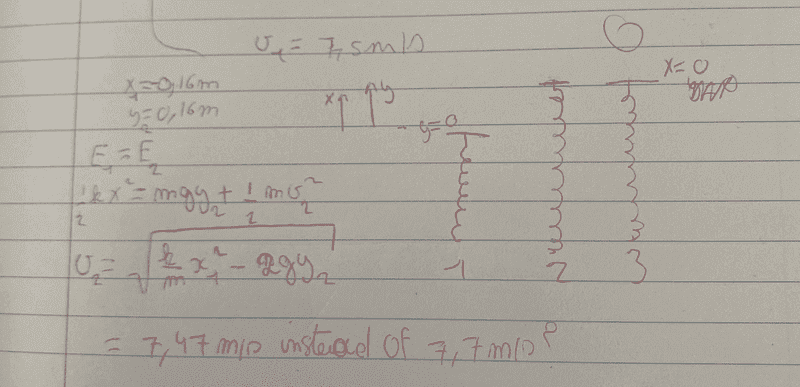

for (a): I basically got the correct answer, but when resolved with taking different reference lines/frames I got a different answer.
for the 1st attempt I took y = 0 (for both ##U_{el}## and ##U_{grav}) at the position where the spring is uncompressed.
for the 2nd attempt (with wrong solution) I took y = 0 for ##U_{grav}## and x = 0 for ##U_{el}## as is shown on the following picture.
have I made a mistake or is this simply not possible?

Is that a picture of attempt (1) or (2). I love a good diagram, and this is not a good diagram nor is it a particularly good explanation of what is shown. Present the first solution too that you think is correct.

simphys said:
for the 2nd attempt (with wrong solution) I took y = 0 for Ugrav and x = 0 for Uel as is shown on the following picture.
for the second one
It's also better if you save the pictures for diagrams and show your math in Latex. It makes a cleaner read for a potential helper. Also, doing these things (while may seem time consuming) helps you to slow down and organize your thoughts, which can often help you to find the discrepancy on your own.
You didn't like my diagram? :(
How could I improve upon it?
and what do you mean not a good explanation?
And Yeah you're right on that no need to rush, best to do a couple of ex than the whole selection lol.
I will do that. To be honest, I normally put ? with unknowns and ! with knowns and then solve. not on this one for some reason.
I also can't understand where you took your zeroth level of potential energy for the gravitational and spring potential energy. if I understand correctly however, when you took different zeroth levels for each of the PEs then you didn't get the expected result ,right?
The natural choice ( or at least what I would do to solve this problem) is to get the zeroth level of PE for both where the spring is uncompressed.

Now regarding the original post. Evidently you want to see what happens when you choose a different zero for the potential energy. Frankly, I too do not fully understand what you did but this is what I would do.
First I define an arbitrary origin of coordinates on a one dimensional axis
Let ##x_0=## the position of the tip of the spring that is free to move when it is relaxed.
Let ##x=## the general coordinate of the tip of the spring that is free to move.
The force that the spring exerts as a function of the tip's position is ##F(x)=-k(x-x_0)##
The potential energy function is, by definition, $$\begin{align} & U(x)=-\int_{x_{\text{ref}}}^xF(x)dx=+k \int_{x_{\text{ref}}}^x(x-x_0)dx=\frac{k x^2}{2}-k x {x_0}+k {x_0} x_{\text{ref}}-\frac{kx_{\text{ref}}^2}{2}\nonumber \\& U(x)=\frac{1}{2}k\left(x^2-x_{\text{ref}}^2\right)-kx_0(x-x_{\text{ref}}).\nonumber \end{align}$$This expression allows different choices for the origin and the reference of the potential energy. It is convenient to set the origin of coordinates and the reference of the potential at the tip of the spring, i.e. ##x_0=0##, and ##x_{\text{ref}}=0## in which case the potential energy function of the spring is the familiar $$U(x)=\frac{1}{2}kx^2.$$

Thank you for the explanation! I have one questoin however, what would be the difference between ##x_{ref}## and ##x_{origin}##

They can have different values. For example, you can pick your origin at the fixed end of a spring of relaxed length ##L##, in which case ##x_0=L## and the zero of potential energy when the spring is compressed to half its length ##x_{\text{ref}}=L/2## or whatever other values you please. The most convenient choice is at the free tip of the spring for both because the resulting expression is easy to remember.

This is the solution that is not correct by using two different points of reference for U_grav and U_el
And do they need to be the same?

You took ## x_1## to be ##0## from what appears to be measured from ##x_2##, but it's in the computation. In effect you seem to be saying the potential energy of the spring in the diagram labed ##(1)## is ##0##. Is that correct?
erobz said:
You took ## x_1## to be ##0##, but its in the computation. In effect you seem to be saying the potential energy of the spring in the diagram labed ##(1)## is ##0##. Is that correct?
no ##x_1## is 0.16m because ##1## is the initial possition
Well look at like this,
I used the 'most' convenient points for both to be 0 at that point
i.e.
for U_EL x = 0 at uncompressed spring
for U_grav y = 0 at lowest point aka compressed position

Ok, you are saying that:
$$ \frac{1}{2}k x_1^2 = mgy_2 + \frac{1}{2} m v_2^2 $$
is incorrect?

presumably, yes or those datum lines are just not permitted for some reason Is my assumption?
Hmmm. I disagree.

I am sorry... my initial equation was simply wrong aka the solution of 7.7 m/s because I forgot to include the ##U_{grav}##

Hence the importance of providing the "correct" solution for people to examine as well!
