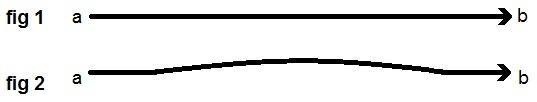

This Quote addresses the heart of my question,
Fig 1 is a straight path of light
Fig 2 is a path of light that is bent by Gravity
the question is will both rays of light reaches from (a) to (b) at the same time?
In GR, where the space is curved, how would you like to define the "straight path of light"? The light will never take that "straight path" as gravitational lensing is a real thing, so the only thing you can compare is "how long would light take to go from A to B if there were no central mass compared with how long would light take to go from A to B with the presence of the central mass?" The answer to that is "without the central mass, the light takes a slightly shorter time to get from A to B, the longer time required in the presence of the central mass is the Shapiro delay". http://en.wikipedia.org/wiki/Shapiro_delay

Excellent Information. thanks Matterwave
Also, just fyi, the "bent" path IS a straight line, called a geodesic, in space-time, which follows Riemann geometry, not Euclidean geometry.
