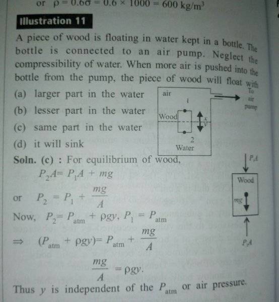

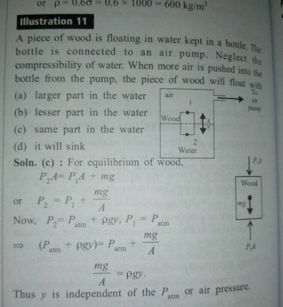

Please clear another doubt from an illustration given in the book . If you remember , I had asked a similar question earlier on the forum . Since this is an example , this has left me wondering if their logic is correct .
Don't you think , correct answer should be option b) ? Since more air is pumped in , the density of air increases which results in increased buoyant force due to air . Since weight of the block is same , this leads to a smaller buoyant force from the water .
Their assumption of Patm both at the top of the block and at the surface of water is not correct .
Please let me know what you think .
There are several awkwardnesses in the question. You are quite right that the increased air density will cause the wood to rise, if the wood is airtight and rigid. But what if air can seep in, raising the weight? Or if the wood compresses, raising the density?
Likes Jahnavi
Where ? Air seep in wood ?
Yes. Water can seep in slowly; maybe air can seep in faster.
