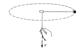

A mass ##m## whirls around on a string which passes through a ring. Given that gravity is not present and initially the mass is at a distance ##r_0## from the center and is revolving at angular velocity ##\omega_0##. The string is pulled with constant velocity ##V## starting ##t = 0## so that radial distance to the mass decreases. Find ##\omega (t)##
There is no tangential forces on the block and the only radial is tension which is not required.
Anyhow, ##r = Vt## since the velocity is constant, ##\dot r = V## and ##\ddot r= 0##.
Pluggin those in,
##\vec a = \hat r(\ddot r - r \dot \theta^2 ) + \hat \theta (r \ddot \theta + 2\dot r \dot \theta)##
##\vec a = -\hat r (Vt \dot\theta^2) + \hat \theta (Vt \ddot \theta + 2V\dot \theta)##
Since there are no tangential forces,
##Vt \ddot \theta + 2 V\dot \theta = 0 \iff t \ddot \theta = - 2\dot \theta##
Since ##\dot \theta = \omega##
##\displaystyle t \dot \omega = -2 \omega \iff {\dot \omega \over \omega} = {-2 \over t} \iff \int^{\omega}_{\omega_0} {d\omega \over \omega} = \int^t_0 {-2 \over t}dt##
Now the second integral has the closed form ##\ln |t|## which is not defined at ##t = 0##,
Where did I go wrong ?

The radius decreases, so it is not Vt.
Angular momentum about the hole is conserved

t=0 is the instant at which the pulling starts. At that time, r should be its initial value still.
Ok I did it.
At any instance ##r = r_0 - Vt##
Which gives ##\vec a = -(r_0 - Vt)\hat r + \hat \theta((r_0 - Vt ) \dot \theta + -2V\ddot\theta)##
So, we get ##(r_0 - Vt ) \dot \theta = 2V\ddot\theta##
Substituting for omega,
##\dfrac{\dot \omega}{\omega} = \dfrac{2V}{r_0 - Vt}##
Integrating from ##\omega_0 \to \omega## and LHS and from ##0 \to t## on right,
I get ##\omega = \dfrac{\omega_0 r_0^2}{(r_0 - Vt)^2}##
Is this correct ?
Second part of the question was to find the radial force on the block,
Which I think is ##F_r =m(r_0 - Vt)\omega^2## and I plug from above in this formula,right ?

Yes, that all looks right.
Will this solve the question without solving a DE ?
I guess so
zwierz said:
I guess so
Ok I will try.
