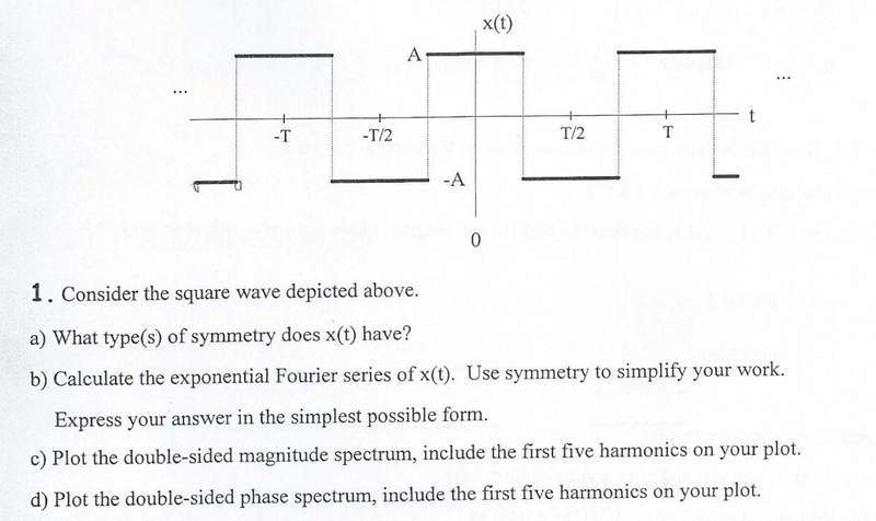

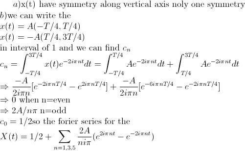

This is A and B my friend is telling me that Co is actually 0 and I am getting 1/2 and i don't see exactly what I am doing wrong if i indeed am doing something wrong hopefully someone here can check this out and let me know exactly where i went wrong..
Thanks
You wrote yourself that c_n = 0 when n is even.
I can't get the second image to open.
Thanks for the reply, i figured out my mistake and redid the problem completely and found the correct answer.
