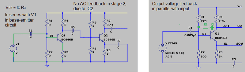

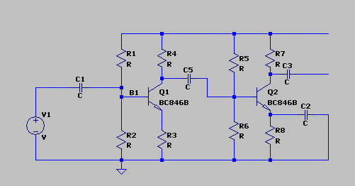

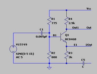

So i want to make a Stage Three: Two Stage Amplifier with Voltage Derived - Parallel Applied Feedback and a Stage Two: Two Stage Amplifier with Voltage Derived - Series Applied Feedback
But am not sure how to layout it out correctly because i have never done this before so i layout'ed it out how i would think it would look like :
I'm not all that clear on what you are asking and I'm no expert, but since you have no replies, I'll have a stab.
In your first diagram, I can see voltage series feedback around the first transistor, but no two stage FB.
Similarly in your second I can see single stage voltage series FB by R3.
I've added typical single stage voltage parallel FB in green.
If you'd like to explain your issues a bit more, I'll try to help if I can
