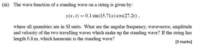

Standing question - real straightforward- Workings given
  • Thread starter Thread starter elemis
The discussion revolves around calculating the harmonic of a wave given specific parameters: W=27.2, K=15.71, and A=0.1. The initial calculation suggests a harmonic of 4.5, which is problematic since harmonics must be integers. The user notes the presence of a node at one end and an antinode at the other, indicating a specific wave configuration. They also calculate the wavelength as 0.4 using K=2π/λ. Clarification is sought on whether their assumptions about the wave's characteristics are correct.
elemis
162
W= 27.2
K=15.71
A=0.1
Now to determine the harmonic.
This formula gives the harmonic to be 4.5. This can't be possible since n has to be an integer.
I realize this wave has a node at one end and an anti node at the other.
I also realize that this wave on the string has a wavelength =0.4 by using K=2pi/lambdaWhat do I do ? :(
Or am I wrong in assuming this is a wave has a node at one end and an anti node at the other ?
