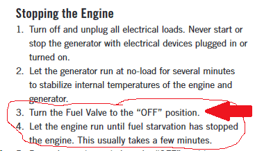

When you shut off the engine the carburetor is left full of gasoline.
When the unit sits for months gasoline evaporates from the carburetor leaving only the non-volatile parts behind, often in the form of a heavy varnish like gummy gooey layer. It plugs up the tiny passages in the carburetor.
The ounce of prevention to keep this from happening is to empty the carburetor before putting the unit into long term storage. Find the fuel shutoff valve and close it, let the engine run until it has used all the gas that was in the carburetor. Usually takes two or three minutes at idle, less if loaded. Alternately you could siphon all the gas out of the tank and run the engine until it's out of gas.

Did you follow these instructions in the owner's manual page 14?
and page 18 where they continue with instructions how to clear the jets and oil the piston rings.
