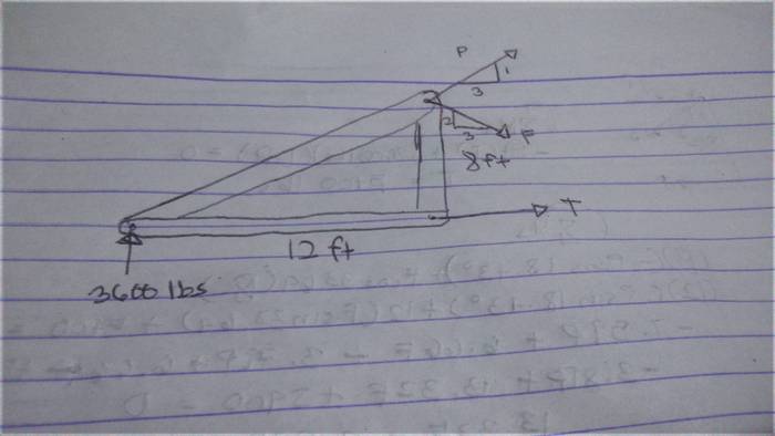

1. Homework Statement
Find forces P,F,and T
Fx = 0
Fy = 0
So far I only got force T from getting the moment from point b. Don't know how-to start getting force P and F since they're both at the same point. Any help will be much obliged thank you

Welcome to PF!
What do you mean by Fx = 0 and Fy = 0? Have you tried to use these?
TSny said:
Welcome to PF!
That means that all forces on x and y-axis must equal to 0 since it's on equilibrium
Do you mean that the sum of the x components of all of the forces must be zero? Similarly for the y components?
If so, have you tried using these facts?

Looks like the force P might be acting down and to the left according to the second picture in post #1.
If its not at equilibrium, then can't I say that the force along the rod at both ends should be equal? (Assuming the rod does not extend)
Oh God sorry. Force P is down to the left. It's on equilibrium, just have to find what the other forces are that are F and p that contribute to the cancellation of the other forces
How would you write out ΣFx = 0 for this problem?

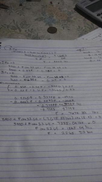

tried using process of elimination to find P and F so far I got the answer not sure if it's correct
OK, your process looks correct. I'm too lazy today to get out my calculator and check all the numbers.
Thanks
I put the equations into some software. It gives somewhat different answers than what you are getting. Could be round off errors. For example sin(33.69) = .5547 instead of .55.
Note that using the little triangles allows you to have exact expressions for the sines and cosines of the angles. For force P, the hypotenuse of the triangle is √10 so you can write the sine of the angle as 1/√10 and the cosine as 3/√10.
Force P then comes out to be 2400√10 . Likewise F can be expressed as a nice number times √13.
