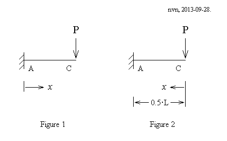

raymanmusic: Your answer for fcc on p. 2 is correct. Your answer for delta_qc on p. 1 is currently wrong. Therefore, let us focus on only p. 1. First, we need to mention something that is making your work unclear, and hard to check. It causes people to be baffled, and therefore, they might not respond.
You are failing to label the points on your free-body diagrams (FBDs). E.g., your last two FBDs on p. 1, and your last two FBDs on p. 2, have no points labeled on them. Therefore, we do not know exactly where the FBD is located. (For your other FBDs, we can guess the points, although we should not be forced to guess; it is easy to label the points, regardless.)
Note that if a point is at a varying section cut, only then can you omit that varying section cut point label.
Secondly, you are failing to show your coordinate system on each of your FBDs. E.g., on your last two FBDs on p. 1, you give a dimension labeled with a domain of x, such as 0 < x < L. This, by itself, is not too useful. You need to show the origin of your x axis, and the direction of x. It might look something like as shown in my attached file.
Arbitrary examples are given in my attached diagram. Notice, in both figure 1 and figure 2, any known points are labeled (points A and C). And in both figures, my coordinate system origin and direction are defined and shown. In figure 2, I also show relevant dimensions, in case they were not previously shown in an earlier FBD.
Therefore, if you could first label the points in your FBDs, and show your chosen coordinate system on each FBD, and repost your attached file, then we might be able to understand what you are talking about. And then we might be able to find where you went wrong in your solution.

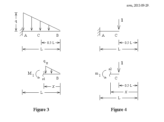

thanks for answering nvn. I labeled my FBD and added x-coordinate system. I'm struggling with finding an expression for the deflection at c with the triangular load. The triangular load is from 0 to L, but my point load is from 0 to L/2. I had to look in my book to find the elastic curve formula for triangular load on a cantilever beam and put x=L/2. I then got an expression for the deflection at C: (Q(L^4)*49)/(3840EI). My final expression for reaction force at C is then: (QL*49)/(160). Do you know how you calculate the deflection for a triangular load on a cantilever beam at midspan without using the the elastic curve formula?
Attempt at a solution: http://goo.gl/ueOAX6
I used beam type nr. 4 and used the elastic curve formula under "deflection at any section in terms of x": http://goo.gl/esY5D
raymanmusic: Your answer is correct.
Now going back to your original approach, see my attached diagram, below, to compute delta_qc. Hint: Sum moments about section cut s1 in figure 3, then solve for M1, to obtain an expression for M1. Next, sum moments about section cut s2 in figure 4, then solve for m1, to obtain an expression for m1. Now see if you can finish it, and obtain delta_qc.

Thank you so much. I followed your hints, I think I got it right now. I got my expression for deflection at C to be:\frac{QL^4}{80EI}
I don't know why, but my new answer for the reaction force at C \frac{3}{10}QL is a bit less than my previous answer \frac{49}{160}QL. It' only 0.00625 difference so I don't think it matters that much. Thanks for the help!
Attempt at a solution: http://goo.gl/ac2dQg
raymanmusic: Your expressions for M1 and m1 are correct. Nice work. But your answer for delta_qc is currently wrong, because your limits of integration are wrong. Your upper limit (L) is correct, but your lower limit is currently wrong. Try again. I.e., try computing delta_qc again.
Of course, it's from \frac{L}{2} to L. Deflection at C is then: \frac{49QL^4}{3840EI} and reaction force at C is: \frac{49QL}{160}
Nice work, raymanmusic. Your answer is correct.
