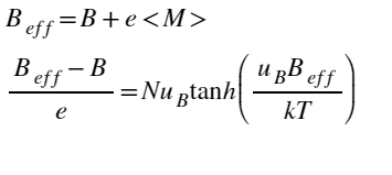

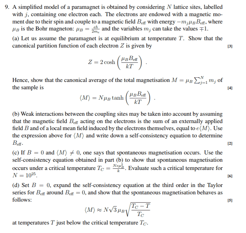

I don't know how to solve part c and d.
Attempt:
c) B_eff=B+e<M>
Substitute T_c into the equation in part b,
=> (B_eff-B)/e = Nμ_B tanh(B_eff/(N*e*μ_B))
Then?
Thank you.
DrClaude said:
Could you show what you got for part b?
241154
I just rewrite the equation I found on part A to an equation containing B_eff only... is it what a self-consistency equation mean?...
A self-consistency equation for ##B_\textrm{eff}## means that you get an equation for ##B_\textrm{eff}## that depends on itself. You could solve it numerically by guessing the value of ##B_\textrm{eff}## in the hyperbolic tangent, then calculating ##B_\textrm{eff}## on the left-hand side, and iterate until the value of ##B_\textrm{eff}## doesn't change anymore.
Your equation for (b) is correct. For (c), I think you can assume that ##B_\textrm{eff}## is small or, more properly
\mu_\mathrm{B} B_\textrm{eff} \ll k T

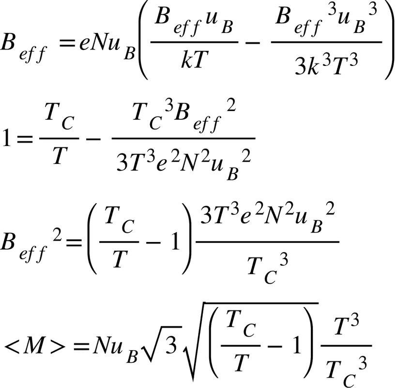

I did part c using your hint
Four stacked equations: B_eff = eNu_B(B_eff u_B/kT - B_eff^3 u_B^3/(3k^3T^3)); 1 = T_C/T - T_C^3 B_eff^2/(3T^3 e^2 N^2 u_B^2); B_eff^2 = (T_C/T - 1)(3T^3 e^2 N^2 u_B^2)/T_C^3; <M> = N u_B sqrt(3) sqrt((T_C/T - 1) T^3/T_C^3).
However in part d), how to deal with the cube term T^3/T_c^3?
You didn't get the expected answer, which is given in the question. There is no need to keep the cubic terms.
Thank you, the answer I displayed above is for part d. The (T/T_C)^3 in the last line should be (T/T_C)^3/2. The expect term have no factor (T/T_C)^3/2, but there is one in my expression...
Above, you wrote
B_\textrm{eff} = e N \mu_\mathrm{B} \left( \frac{B_\textrm{eff} \mu_\mathrm{B}}{kT} - \frac{B_\textrm{eff}^3 \mu_\mathrm{B}^3}{3 k^3T^3} \right)
which means you took
\tanh(x) \approx x - \frac{1}{3} x^3
Try instead ##\tanh(x) \approx x##.

However, in part d the question says expand it to 3rd order?
Sorry, I was looking at part (c). The solution to (d) is not obvious to me, I'll have to think a bit.
In post #5, on the last line, you made an error when taking the square root.
To get the equation given in the problem, I had to assume also that ##T/T_C \approx 1##, as stated in the problem.
