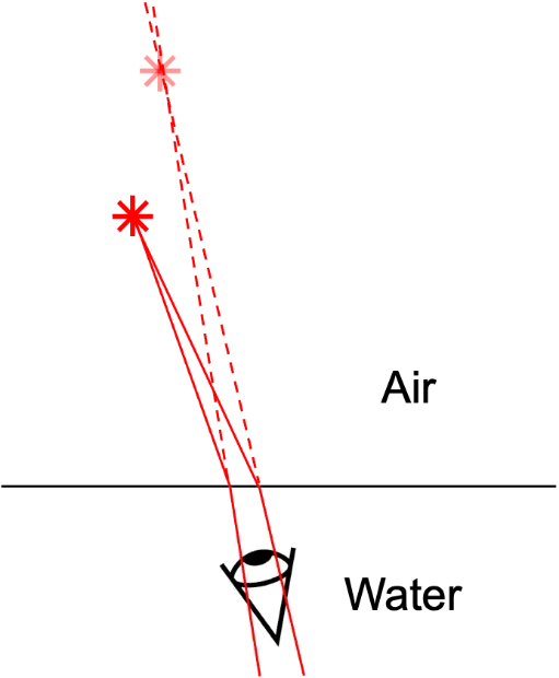

I mean that the eye, instead of being in air looking down to the bottom of the cube which is under water, is in the water looking up to the top of the cube which is in air. The situation is shown in the picture on the right. The red star is a point at the top of the cube (not shown) emitting rays of light in all directions. Only two of these rays are shown.
If one extends the refracted rays above the surface into the air (dashed lines), the apparent position of the top of the cube will be at their intersection. Note that the apparent height above the surface is greater than the true height. What does that imply about the apparent total height of the ice? Is it going to be greater or smaller than the true height of 10 cm?

When dealing with Physics assignments, I am willing to assume everything is frictionless, there are no aerodynamics, and things like levers and ropes are massless.
But putting an eye or camera underwater is a different matter. We need to be explicit about what constitutes a "vanilla" camera - the one we store on the same shelf as our massless "vanilla" rope and our frictionless "vanilla" slide.
In most cases our vanilla camera will be a pin hole camera with a flat "retina". And although the pin hole has a diameter of zero, there will never be a problem with exposure time or resolution.
When it comes to putting this "vanilla" camera under water, there are two flavors of "vanilla".
Flavor 1 is leak-proof and keeps the optical properties of the camera exactly as it was.
Flavor 2 is well vented and will fill the distance between the pin hole and the retina with the same transparent media that is found outside the camera.
Drawing the set up with the observer depicted as a disembodied eye, strongly suggests the Flavor-1, leakless observer. And, of course, there are other optical issues with the underwater use of a severely non-flat-field lens system such as the eye.
In one of my posts above, I suggested using an eye / camera encapsulated within an air pocket (swimming goggles).
Since the problem description has not addressed this issue, I suggest posters in this thread describe the "flavor" of their observers.
