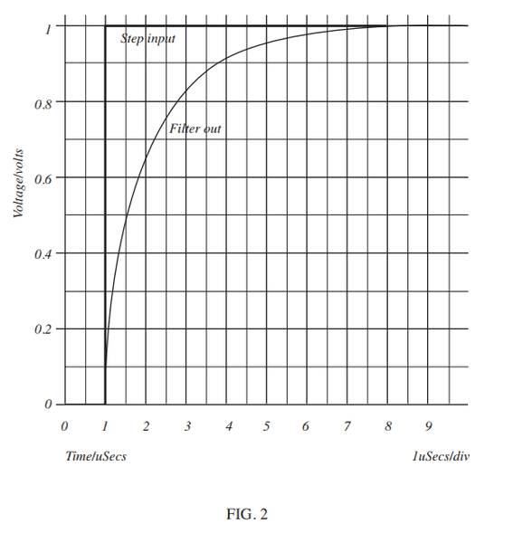

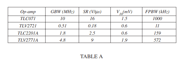

Select (with justification) from the op-amps listed in TABLE A those which are NOT suitable for use as the active component in the filter of (a) above.
Graph of voltage in volts against time in microseconds, with a step input rising to 1 V at 1 us and a filter output curve rising smoothly toward 1 V.
Table A listing op-amps with columns GBW (MHz), SR (V/µs), V10 (mV) and FPBW (kHz): TLC071, TLV2721, TLC2201A, TLV2771A, with their values.
Currently The only Op amp I see that is not suitable is TLV2721 due to slow slew rate of 0.18 V per micro second.

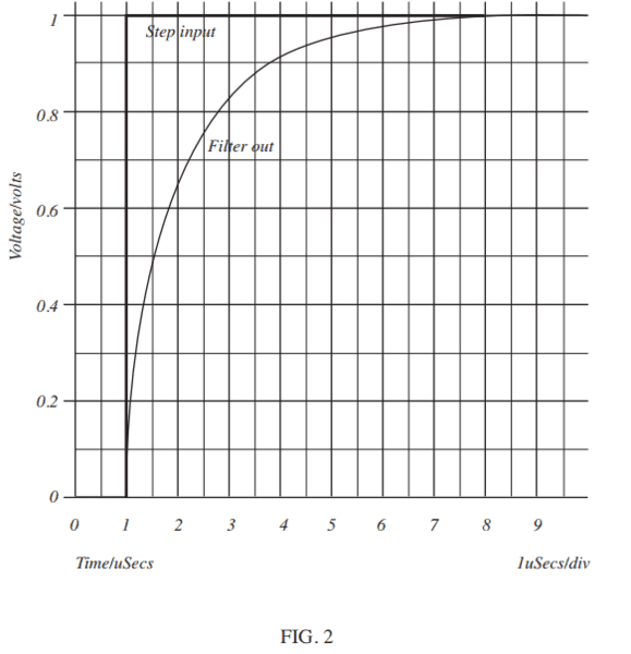

  • Graph of voltage in volts against time in microseconds for a step input and filter output, showing the filter output rising exponentially from 0 towards 1 V.

  • Table A of op-amp specifications with columns Op-amp, GBW (MHz), SR (V/µs), V_IO (mV) and FPBW (kHz), listing TLC071, TLV2721, TLC2201A and TLV2771A.

I would look at that slew rate for the first 0.1us, and make my choices based on that...

Yes, that is what I would do. Look at the very start of the waveform where the slope is the steepest -- the opamp needs to be able to keep up with that slew rate to match the specs. I only see one opamp that comes close...

So do we have a slew rate of 2V/us at 0.1us?
That's about what I got as well. So what is the ballpark slew rate needed per us?
So would this make the 2.5V/us op amp the correct choice as the others are either too slow or above spec?

No. Sorry, but I guess I misread your reply... "slew rate of 2V/us at 0.1us" is not right. It is 2V/0.1us, which equals what slew rate per us?

Yes, better. So only one opamp in the table comes close to that, right?

It's the best you can do with those selections. And the problem just asks you to eliminate the ones that are not suitable anyway. And 16V/us is reasonably close to 20V/us...
Hi, sorry but when going back through this I got a little confused as to how you came up with 2V/0.1us. On the graph at 0.1us the voltage is 0.2V so therefore should the slew rate be 2V/us? Am I missing somthing.
Then I am too. I also see 0.2V at ~ 0.1 uSec, and that would be 2V/uSec, eliminating only one op-amp.
Another op-amp might be marginal, considering we are estimating from a graph here, and it would be steeper for the first 0.05 uSec, but we are hitting diminishing returns for a practical matter.
Oops, I think you are right. Thanks for catching my error.

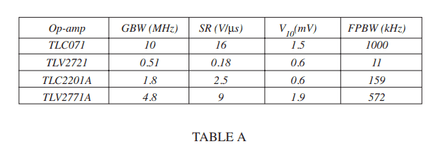

No problem, so with this then is it safe to say that the TLC2201a is suitable and the other 3 are not. 2 of them are above spec is it reasonable to state that they are not suitable due to being above spec or do you think they will expect more?
Also out of curiosity is there any other drawback to going above spec in terms of slew rate other than cost and power consumption?
No, IMO being faster than needed is fine, and should not disqualify them.
Being faster, they may be a bit more expensive, so you might eliminate them from your search for that. But on technical grounds, I think they should be fine. If there were other criteria given in the problem (like current consumption or input offset voltage, etc.), then you might be able to eliminate more of the parts on technical grounds.
Thanks so 1.5+ mV input offset is too large where as 0.6 mV is negligible and therefor this is still the only suitable op amp, is this a fair statement?
Depends on the circuit. In some circuits, the input offset voltage doesn't matter much. Are you given more of the circuit or additional constraints, or just the time domain step response graph that you've posted so far?

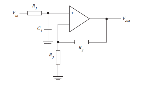

I have not been given any circuit paramaters other than the step response of the output and I am to determine which op amp is not suitable. With no information with regards to offset correction etc. I am assuming the circuit is simply RC filter with a voltage follower op amp configuration.

If there is no more information than the step response graph, I don't think you can go much farther. If you have a typical filter circuit that you have been studying as part of this unit, then you might be able to say more. If you are using a DC follower after the filter, then the input offset voltage (or input offset currents) may come into play.
Updated this comment as there isn't a circuit I got mixed up sorry.
  • Circuit schematic of a second-order active low-pass filter using an op-amp: Vin feeds R1, then C1 to ground at the non-inverting input, and R2 with R3 set the gain to Vout.
