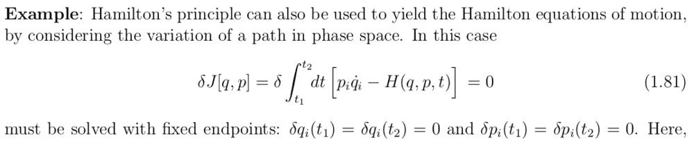

I just bring only one example from the text cited in #2.
page 23:
The author suggests to consider variations of this functional in the class of curves with fixed ends in the phase space. It is pointless and it does not correspond to the well-known ##\int Ldt##.
Indeed, the Hamiltonian equations are of the first order and if you fix a point in the phase space you also fix a trajectory that passes through this point (existence and uniqueness theorem) . This trajectory is not obliged to pass through the second point you fixed. Moreover if you fix two arbitrary points in the phase space, the probability that these points are appeared to be connected by a solution to the Hamiltonian system, will be equal to zero. It is so even if the points are close to each other.
Thus the functional ##J## (according to this text) does not have stationary paths almost certainly. In the correct statement (see for example cited above Arnold's book) one fixes only ##q## positions at the ends of the path and does not fix impulses ##p##. This corresponds to the Lagrangian situation (##\int Ldt##) when we also fix ##q## positions and do not fix velocities ##\dot q##.
Well, that's a severe mistake also for physicists' standards of rigor. It's simply a wrong statement, which I can't remember having encountered in the literature before.
