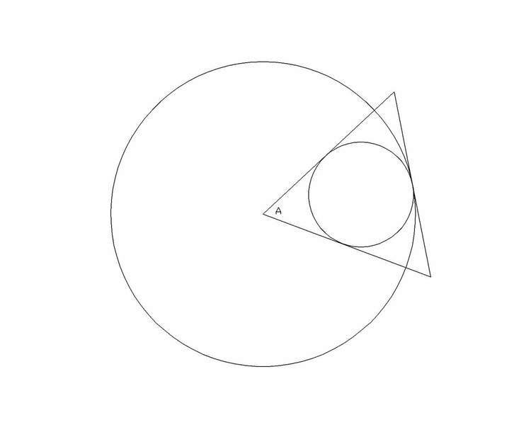

Here's a pic of what you described.
Note that the small circle is inscribed within a triangle; 2 sides that intersect at the center of the large circle. The 3rd side is tangent to the point where the 2 circles intersect and, thus, perpendicular to the radius of the large circle at that point.
  • Geometry diagram of a large circle with a sector-like triangle whose two sides meet at the centre, angle A marked there, and a smaller circle inscribed inside the triangle, touching the large circle.
sutupidmath said:
And, i think we are supposed to find the radius of the circumscribed circle, since we want to fit the sector taken out of the circle with radius 1 in this other circle.
but the circumscribed circle is the original circle of radius 1
and "fit" usually means inside …

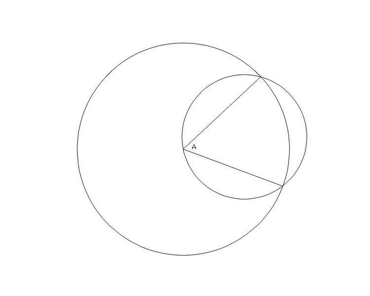

sutupidmath said:
Problem: Given a circle of radius 1. Take a sector of this circle with internal angle A, where 0=<A=<pi/2. Find a formula for the radius of the smallest circle that will perfectly fit this sector, as a function of A.
Actually the circumscribed circle (the circle that circumscribes the described sector is smaller than the original circle (see attachment).
  • Geometry diagram: a large circle with a smaller circle passing through its interior, with a center point labelled A. Two chords radiate from A to the points where the circles intersect, forming a sector.
The circle in my last post "fits" around the sector.
Since the OP stated "the smallest circle that will perfectly fit this sector," I believe that is the circle he is looking for (not the first picture I posted).
... and, in this case, we're talking about how the sector perfectly fits inside the circle.
Well, my answer was correct! :)
