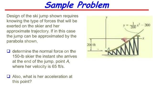

Slide titled Sample Problem showing text about a ski jump and a diagram of a parabolic ski jump curve y = (1/200)x^2 - 200, with point A at its base and a 200 ft height marked.

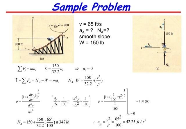

Slide titled Sample Problem: a skier on a curved smooth slope with the curve y = x^2/200 - 200 beside a sketch, and diagram (b) showing the skier's normal and tangential accelerations and forces, with the 150 lb weight and N_A.
Can anyone explain why sum of Ft has been set to be = 0? The slope is smooth so no frictional forces act but by setting it to 0 they are neglecting the component of the weight along the slope? Having said that, this is a curved slope and not a straight one so does the component of the weight along the direction of motion vary continuously (since theta varies?)
If it's a parabola what is the slope at point A ?
It's 0?
So what is the "component of weight along the slope" at point A?
