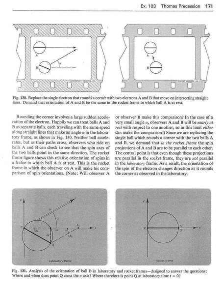

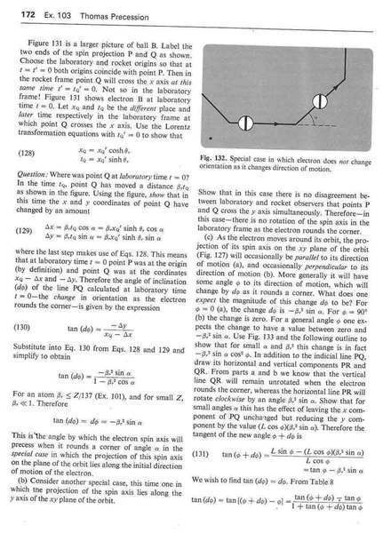

The quality of the image has suffered a bit in the attachment process. In the left hand diagram of Fig. 131, the line segment between Q and xQ is labelled betartQ. The angle on the left is d phi. The other two angles are both called alpha.

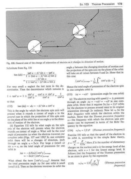

The two rightmost labels in Fig. 133 are:
[tex](L \cos \phi)(\beta_r^2 \sin \alpha)[/tex]
and below that:
[tex]\beta_r^2 \sin \alpha[/tex]

Parts (a), (b) and (c) mention two inertial frames of reference: a "laboratory frame" (unprimed), and a "rocket frame" (primed). Borrowing Kevin Brown's notation, I'll call them K and K', and use K'' for the rest frame of ball B. The rocket frame, K', is equated with the rest frame of ball A which is moving right along the x-axis of K, according to figures 130 and 131. In the scenario shown in Fig. 131, is the x' axis parallel to the x-axis according to K?
Yes. You do get aberration effects in SR, i.e., directions and angles aren't invariant under Lorentz boosts. But by symmetry, a line can't be reoriented by a boost parallel to itself.
Rasalhague said:
Is the x' axis parallel to the x-axis according to K'?
Yes. This is basically equivalent to the previous question, except that the direction of the boost is reversed.
Rasalhague said:
Is the x' axis parallel to the projection of the spin of B onto the xy-plane? Does this last question have a frame-independent answer;
No, the answer is frame-dependent.
Rasalhague said:
if not, how would it be answered wrt K and K'?
In K, it's not parallel (left-hand panel of figure 131, where the distinction between the directions of x and x' is irrelevant). In K' it is parallel (right-hand panel of figure 131).
Rasalhague said:
Which frame is Fig. 132 drawn according to? Since the angle alpha is defined in the laboratory frame, K, I guessed it would be K. In support of this is the fact that no obvious distortion of the polygon is shown, no squashing in the direction of motion of A. On the other hand, part (c) seems to be contrasting something being parallel (in part (a) and Fig. 131) with something being perpendicular (in part (b) and Fig. 132); and it's only in K' that the spin projection of B is parallel to the direction of movement, which suggests that Fig. 132 is according to K', perhaps with alpha representing a different angle. I'm presuming the angle alpha is changed by a boost from K to K'.
Yes, I think it's drawn according to K, for the reasons you gave. Although alpha would be frame-dependent, I don't think that matters here, because we're carrying out the analysis to lowest order in alpha; at the end, we're going to make the number of vertices on the polygon large, so that alpha becomes small. If you transformed fig 132 into K', I think B's spin would still be perpendicular to the segment of the polygon that A is sitting on top of. That's because K and K' only disagree on simultaneity of events that have different values of x, but when the spin axes are oriented along the y axis, they're lines of constant x. (I'm not totally certain I've got this one right. If you want to make sure, you could probably check by looking up equations for relativistic transformation of angles, and seeing what happens in this special case of a 90-degree angle w.r.t. the boost.)

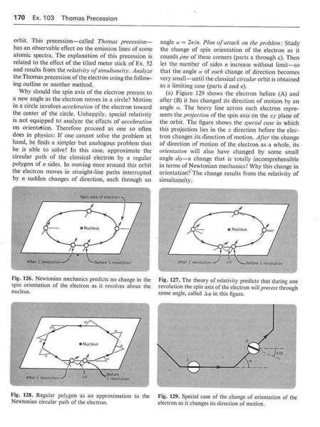

I don't understand how the beginning of part (c)--"As the electron moves around its orbit, the projection of its spin axis onto the xy plane of the orbit will occasionally be parallel to its direction of motion (a), and occasionally perpendicular to its direction of motion (b)"--relates to the actual examples in (a) and (b).
I don't quite follow you here. In (a), the spin is initially parallel to the direction of motion. This initial state is given by electron A.
Rasalhague said:
This is the electron whose spin projection changes direction when we boost from K to K', as part (a) shows.
Electron A's spin *doesn't* change direction when you boost from K to K'. What changes direction is electron B's spin.

So what is the xy-plane? Is it a projection of spacetime (or one of its tangent spaces) such that events (or tangent vectors) which differ only by a t or z coordinate are treated as equivalent. Or does the definition change with a change of coordinates to "...which differ only by a t' or a z' coordinate"?
If B's spin had been parallel to the x-axis in fig 131, then B's spin would still be parallel to the segment of the polygon that A is sitting on top of after the transformation of coordinates to K'. That seems like the analogous thing to say about being parallel: as when perpendicular, no change. (c) says that the projection of the spin axis (of B) will sometimes be parallel to the direction of motion (of A and K', towards which the motion of B is to be approximated) and sometimes perpendicular. But it only says there will be no change when it's perpendicular. When parallel, I think (c) says the angle it makes with the direction of motion (of the boost from K to a frame traveling instantaneously with B) will change by [itex]-\beta_r^2 \sin \alpha[/itex]. But this equation was derived for the case shown in fig 131 where the spin projection of B is not parallel to the direction of motion along the x axis. So it doesn't seem to be comparing like with like.
Alternatively, if it's talking about electron A, its spin is parallel to the direction of motion, and, as you said, doesn't change. And it's the fact of being parallel (or perpendicular) that ensures a spin projection doesn't change doesn't change, in which case, how can they state that for phi = 0 (parallel) there is a change of [itex]-\beta_r^2 \sin \alpha[/itex]?
Hmm, I suppose the rule is "measure d phi after the boost". In (a), and fig 131, phi is rigged to be the same as d phi. What is the significance of that? It must be to make the different electrons A and B somehow as if they were the same electron. But that seems to suggest a single electron could have two different spin projections according to K which only coincide according to K'. Presumably the anomaly goes away when the approximation is completed--or more likely I'm still not getting the set-up.
