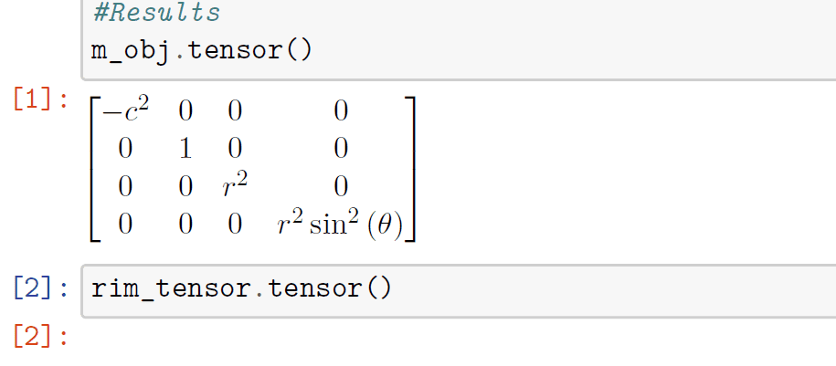

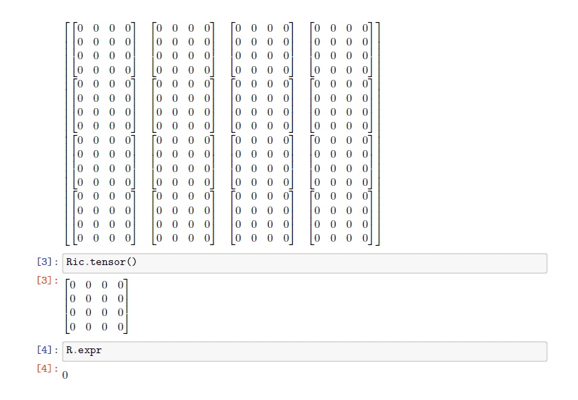

I am thrilled to announce that I manage to run the code and see the output. Here are the results,
I only used 10-15 lines of code (if you include imports etc., it is about 15, otherwise it's 10). It's nice to see that the code works fine. I cannot share the code since it's homework for us, but I can share the solutions so you guys can check (well actually nothing to check since the metric corresponds to a flat universe, everything will be 0). I first started from Python with the EinsteinPy package since I know Python 3. I also used VSCode/Jupyter Notebook/Jupyter Lab, and in all of them, the code works fine. But ıt works best in Jupyter Lab/Notebook
Thank you all for your suggestions/help.

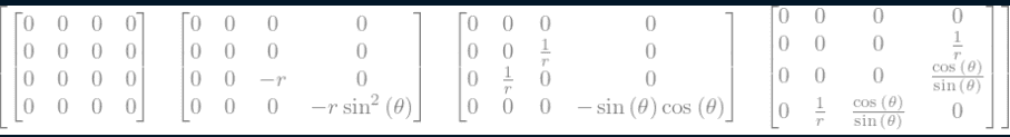

Sorry guys. Okay so this works for me
I just turned it into an array by using
Code:
.tolist()
Such as
Python:
Christoffel_symbol.tolist()
Christoffel_symbol

Regarding direct use of the tensor classes in SymPy, I could never get them to work properly. I ended up using implicit arrays of arrays, etc. It also helps to learn how to define and use basic functions in Python. E.g.,
Instead of tensors, I have used arrays such as
Code:
xtensor = MutableSparseNDimArray(zeros((4,)*2))
By doing this, you can allow for updating your matrix and changing the elements. Otherwise, the code was giving me errors.
