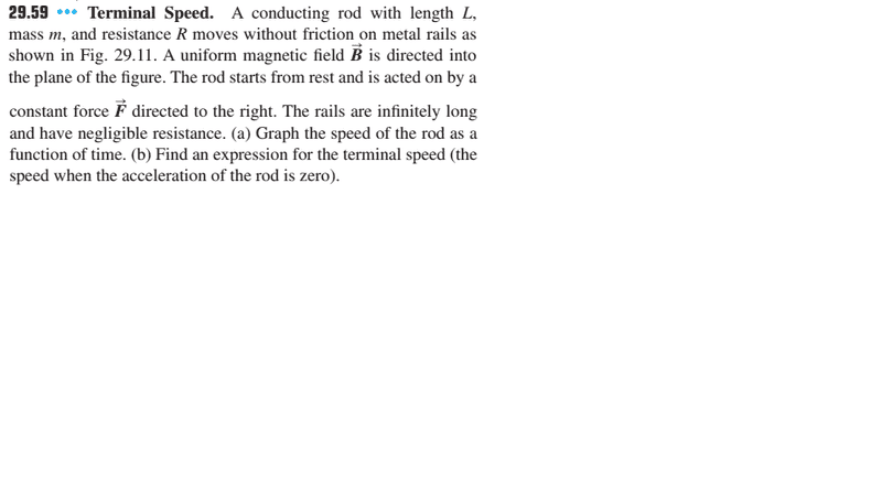

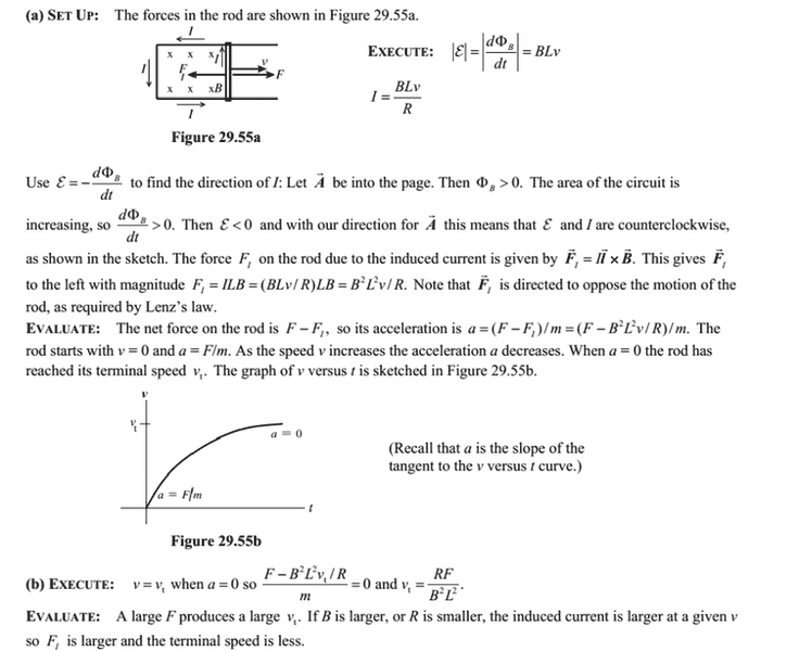

That is the solution:
I think ε≠Bvl because ε = - dø/dt=- Bd(v.t)/dt, v is not constant.
Why ε=Bvl?
