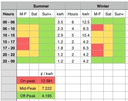

http://www.pge.com/en/mybusiness/rates/tvp/toupricing.page?WT.mc_id=Vanity_tou
I think many areas already have time of use pricing for residential customers.
Not sure 7 kW is enough to run air conditioning and the rest of the house, and AC needs do not stop the moment the sun sets. Still an interesting offer.

I won't rule it out because I don't know every electric company's rate structure, but that isn't an example: that's for commercial customers.
You are right. Wrong link. Here's another page on the PGE site:
http://www.pge.com/en/about/rates/rateinfo/rateoptions/index.page
"There are two basic rate options for single-family, separately meteredresidential customers. E-6 is an optional time-of-use rate schedule for individually metered customers who can minimize their loads during defined time periods."Also here are other utilities that seem to offer time of use plans:
SCE Introduces a New Residential Time-Of-Use Rate Plan
https://www.sce.com/wps/portal/home...t0mKkYfEEvibj1Q!/dl4/d5/L2dBISEvZ0FBIS9nQSEh/
http://www.srpnet.com/prices/home/tou.aspx#save (Looks like Residential Tarriff but not 100% sure)
https://www.portlandgeneral.com/residential/your_account/billing_payment/time_of_use/pricing.aspx
https://www.nvenergy.com/home/paymentbilling/timeofuse.cfm
