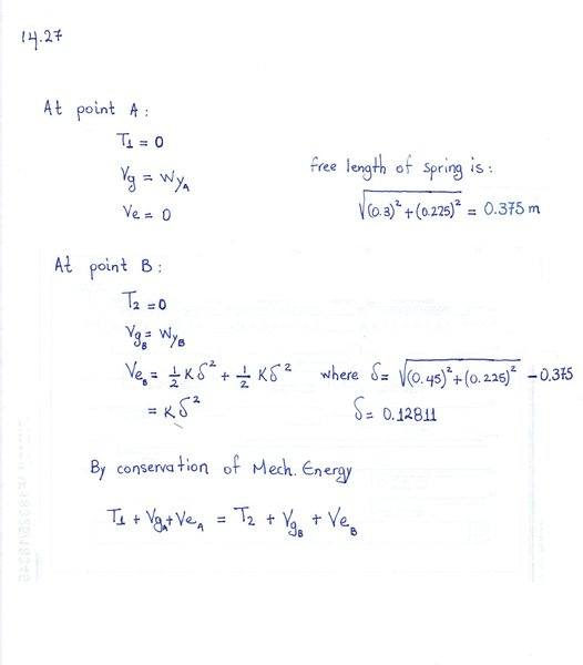

Hi. Can you check if I am going at the right direction?
Also for ##Wy_B## and ##Wy_A## am I replacing with 2.5(0.45) and 2.5(0.3) respectively?

So far so good except for the gravitational potential energy.
Do I replace ##Wy_A## and ##Wy_B## with 2.5(0.3) and 2.5(0.45) respectively?
Almost but not quite. Something is missing. The problem talks about a 2.5-kg weight. Is weight measured in kilograms?
A yes but ofcourse W = mg where mass is m=2.5kg.
But I don't understant why the Potential Energy of W is mg(0.3) at position A and mg(0.45) at position B.
I mean I don't understant it in relation to the Figure.
Can you explain to me a bit more?
At Which point do I say that the potential energy of W is zero? (in the figure)
Any point you like. The zero of potential energy is irrelevant. Consider this, when a mass moves from point A to B, mechanical energy conservation says
TA + UA = TB + UB
or
TB - TA + UB - UA = 0
or
ΔT + ΔU = 0.
It's the difference that matters, not where you put the zero of energy because it drops out.

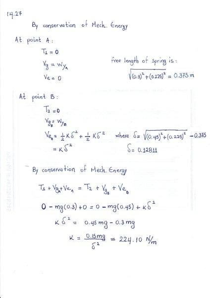

Ok so here is my solution:
I didn't run the numbers, but the method is correct.
