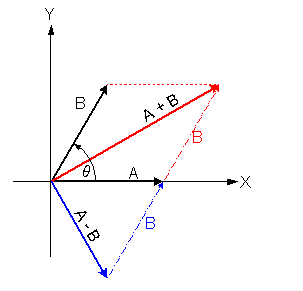

Two vectors A and B have precisely equal magnitudes. In order for the magnitude of A+B to be 120 times larger than the magnitude of A-B , what must be the angle between them?

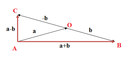

Draw a right-angled triangle ABC where BC is the hypotenuse, O is the midpoint of BC. You wil see that one of the two other sides is the magnitude of the vector-sum and the other is the magnitude of the vector-difference. A bit of trigonometry would lead you to the answer.

Could you please expand?
Like what is the significance of knowing O?,etc

You're free to choose whatever coordinate system and initial vector length you want to solve the problem. I might suggest that you choose a unit vector length and place your coordinate system so that one of the vectors lies along one of the coordinate axes. Then the other vector makes angle θ with that axis.

Then the angle between vectors a and b is two times the angle between BC and AB, which should be calculated using tangent formula.
Okay, I am starting to understand.
so if we name the angle between AB and BC as θ, then we can get it by,
Tan^-1(a-b/a+b)
then we multiply the result by 2
but then... we don't have a and b
all we know is that lAl=lBl
How can that help us get a and b?
Thank you so much btw...you're helping me h=get closer to the answer

If vector A is a unit vector and lies along the x-axis, then its vector components are (1,0). If vector B makes some angle θ with A, then its vector components must be (cos(θ),sin(θ)). You can thus form A + B and A - B algebraically from those components. Write expressions for the magnitude of each and apply your required relationship between them.
But the magnitude of the vector-sum is 120 times that of the vector-difference. The tangent formula only requires a RATIO between two sides of the triangle.
