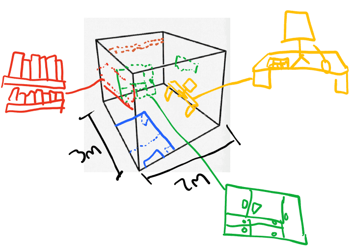

Oh! i now understand.
In fact... for a school display of the electronics class this topic jumped out at me and intrigued me.
So, for a experiment the team buy a very very little camera and put it in a very very very small room (without a person inside, sure).
The half of the team they should to find it (me including)... 1 hour and we don't find it...until we gave up...
This the diagram of the room:
-two small wooden shelves (red): all the books were removed and checked... with nothing found.
-Desktop (yellow): the surface is made of glass and the pc its right
-Little cloackroom wooden (green): the only way to put something is in the front view...maybe a hole...but we don't find anything.
The wall don't have holes and the electrick waves its not in the view...
Any suggestion?
Any nail holes or screws or airflow grating?

The only holes its the electric socket and a empty hole of a spotlight (maybe a photo help?)
The only site I can think is some very very very small hole in the swooden clockroom and the window framework (steel)... but its not anything
The electrical sockets are potential spots.
This is a very basic render of the room (yeah, its very very very small)
Sockets looks fine (green), the steel of swooden shelve too (black), the second electrical socket in the roof i put myself and i don't see anything...
Just have a little hole in the roof (red) and a 3rd empty electrical socket behind the column (up of the cloackroom)...
any idea?
