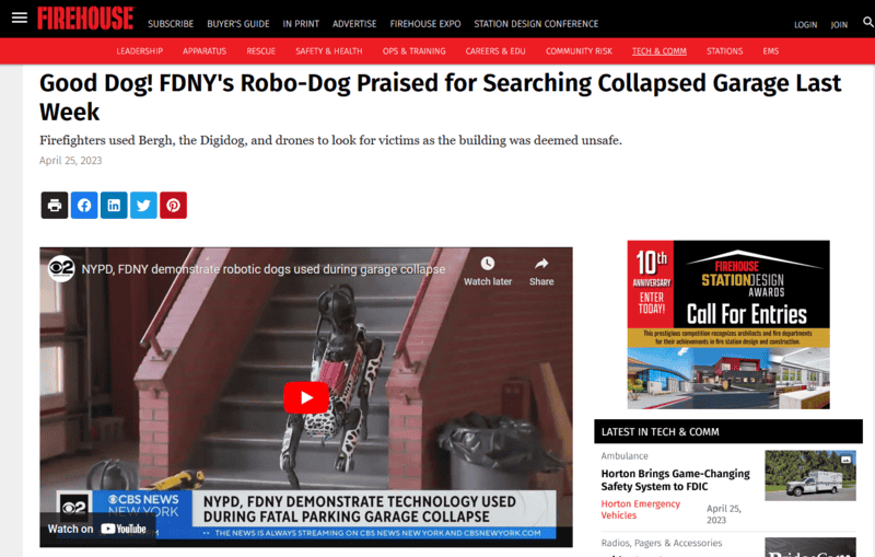

This was a great use of technology last week when a large parking garage collapsed in New York City, and it was too dangerous to send in FireFighters to search for injured and trapped people. FDNY has used Drones for a while now, and has a new Robot Dog that is able to navigate pretty difficult rubble to search for survivors:
https://www.firehouse.com/tech-comm...ised-for-searching-collapsed-garage-last-week
Last week, when a parking garage collapsed on Ann St. in lower Manhattan, the FDNY deployed its so-called Digidog to search for people trapped in the wreckage and survey the scene — a move Adams touted at the time because it eliminated the need to put firefighters in harm’s way. The robot and its handlers were engaged in a training exercise at a downtown high-rise when the garage came down and arrived about 15 minutes after the first distress call went out, Kavanagh said.
“The robotics members went to work quickly, suggesting that the robotic dog could aid in the operation,” she said. “Three drones were also deployed — one overhead to give a clear picture of what was happening on the roof and two inside to assess the situation in there.”
Adams noted that it was the first time in the city’s history that the FDNY and NYPD responded with drones and the Digidog, which is named Bergh. Fabien Levy, Adams’ spokesman, said the FDNY currently has one Digidog and the NYPD has ordered two.
“This is an administration that is not going to be fearful of using everything possible to save the lives of New Yorkers and to save the lives of first responders,” Adams said. “The benefits are not theoretical. Last week, we saw it in action.”
