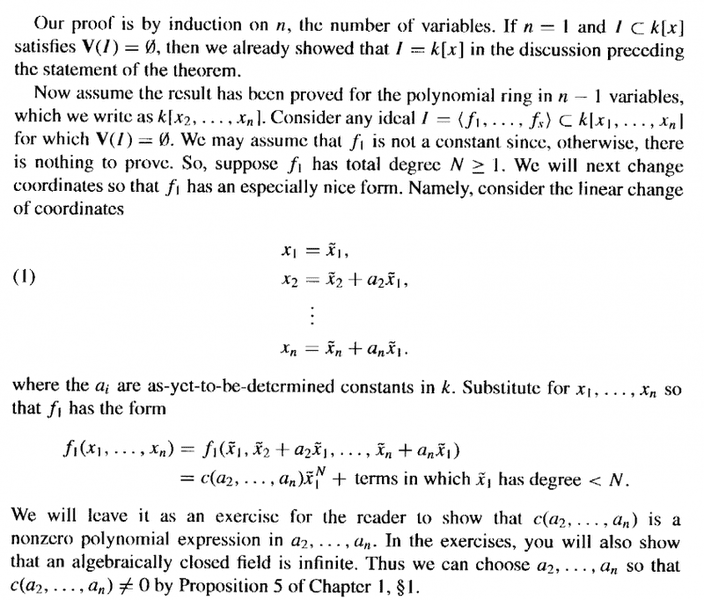

I am reading the undergraduate introduction to algebraic geometry entitled "Ideals, Varieties and Algorithms: An introduction to Computational Algebraic Geometry and Commutative Algebra (Third Edition) by David Cox, John Little and Donal O'Shea ... ...
I am currently focused on Chapter 4, Section 1: Hilbert's Nullstellensatz ... ... and need help with the aspects of Cox et al's interesting proof of the Weak Nullstellensatz as outlined in Exercise 3 ...

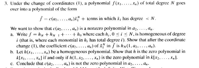

Exercise 3 (Chapter 4, Section 1) reads as follows:

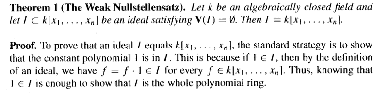

As Exercise 3 refers to aspects of the proof of Theorem 1: The Weak Nullstellensatz, I am providing the first part of the proof of that Theorem as follows:
My question is as follows:
How do we formulate and state a formal and rigorous proof of 3(a) ... ... that is a proof of the proposition that the coefficient ##c(a_1, a_2, \ ... \ ... \ , a_n )## of ##\tilde{x}^N_1## in ##f## is ##h_N (1, a_2, \ ... \ ... \ , a_n )## ... ...

... ... how do we formulate and state a formal proof of the general proposition that the coefficient ##c(a_1, a_2, \ ... \ ... \ , a_n )## of ## \tilde{x}^N_1## in ##f## is ##h_N (1, a_2, \ ... \ ... \ , a_n )## ... ... ?Does the proof just describe the computation process in general terms ... ?Hope someone can help ... ...
Help will be appreciated ...
