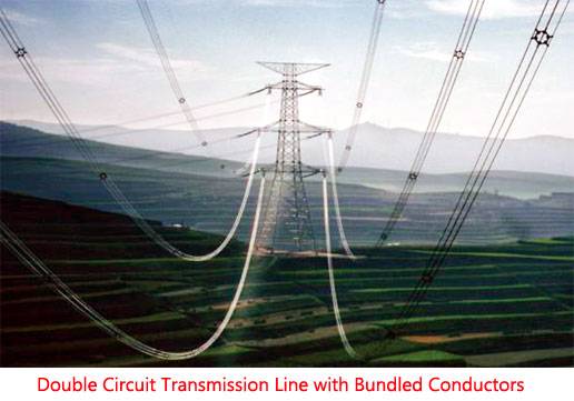

Analysts have tricks to use CA even when circuit behavior is non ideal. Consider the following picture showing two three phase circuits sharing the same transmission towers. The mutual coupling between the two circuits violates the CA assumptions big time. But analysts simply adjust the values of series reactance for both lines to compensate, then put them into the analysis as if they weren't mutually coupled. In other words, they fudge the data to avoid the need to use Maxwell's equations to model the entire power grid (which would be impossibly difficult.) The practice is akin to the transformer equivalent circuit that I showed in the article. Non-ideal behavior is approximated by ideal components and standard CA methods are used to solve the circuit.

Analysts have tricks to use CA even when circuit behavior is non ideal. Consider the following picture showing two three phase circuits sharing the same transmission towers. The mutual coupling between the two circuits violates the CA assumptions big time. But analysts simply adjust the values of series reactance for both lines to compensate, then put them into the analysis as if they weren't mutually coupled. In other words, they fudge the data to avoid the need to use Maxwell's equations to model the entire power grid (which would be impossibly difficult.) The practice is akin to the transformer equivalent circuit that I showed in the article. Non-ideal behavior is approximated by ideal components and standard CA methods are used to solve the circuit. Although I did manage to ship a couple complex SCADA designs with remote control well before Allen Bradley in the late '70's with lots of logic uC analog and robotics. I never got famous or rich from it.
