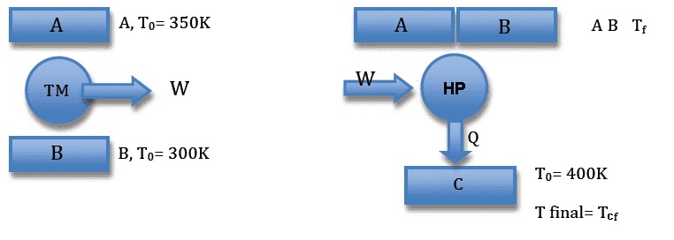

A thermodynamic engine is operated between two cooler bodies A and B, extracting work until the two cooler bodies reach a common temperature T_f. This work is then used as the input to a heat pump, extracting heat from the cooler pair and heating the hot body C. Find the final temperature T_{fC} C if work is maximum.
The initial temperatures for the cooler bodies A and B are: T_{A0}=300ºK,T_{B0}=350ºK, and for the hot body C: T_{C0}=400ºK
The equation of state for the three bodies is: U=aT
So, this is what I did till now.

How do I get T_{Cf} from here?

hey this is off topic but how do u post the image?
I've attached it, and then used the vbcode to make it appear. [*img]url image[*/img] without the * off course. Making a quote of the original post you can see ;)
