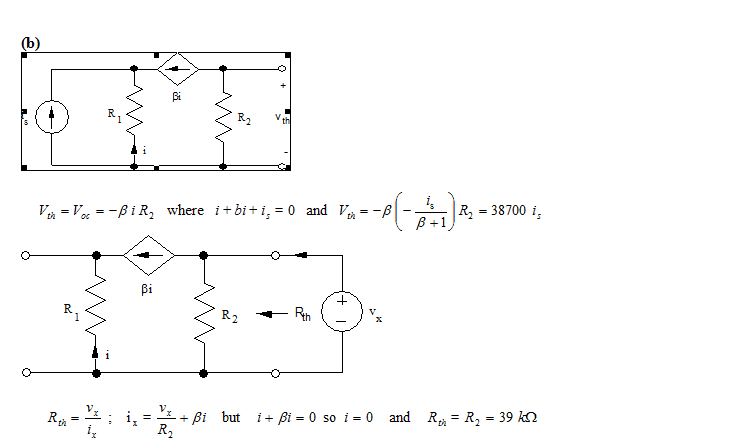

I'm trying to understand where the (β+1) comes from.
2. Homework Equations
vth=-βiR2
i+βi+is=0
vth=-β(-is/(β+1))R2
3. The Attempt at a Solution
vth=-βiR2
i+βi+is=0
vth=-β(-βi-is)R2

Without seeing the original circuit that this is modeling, it's hard to be sure. But for a CE BJT amplifier, your collector current Ic = β * Ib. So your emitter current is...
i've attached the solution that i have in the book, the value of beta is 150 and R1=100k and R2=39k, the only problem I have is that how do you get to the vth while substituting beta and the resistance in both sides to be equal to -Beta (-is/beta+1), the beta + 1 has to come out from simplying and combining like terms but I just can't see it.

So factor out the i in that equation above:
(β + 1)i + is = 0
There's your (β + 1) term.
vth=-β(-βi-is)R2
That doesn't look right. You want to substitute for i in your equation for Vth from above, but what you've stuck in there also contains i.
vth=-β(-βiR2-isR2)
vth=β^2iR2+βisR2
vth=βR2(i^2+is)
vth=βR2(i(i+β+1))
vth=βR2(i)(i+β+1)
