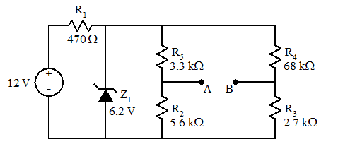

Here's another rendering of your circuit with the components rearranged into a more common pattern:
If the zener is replaced by a short (not a bad approximation since it should have a zener resistance of just a few Ohms when in "zener mode") can you reevaluate your method for determining the Thevenin resistance?

In the original circuit there is voltage source on the left, so you ignore it, look at the circuit from the right and then 6 Ohm is in series with 2 Ohm and 3 Ohm in parallel.
  • #33
Yes, that's a good example. Now, what do you make of the circuit in question? When the zener is replaced by a short, what opportunities for combining resistors do you find?
  • #34
I still see it as in the beginning: R4 and R5 are in series and parallel to R2 and R3 which are in series :/

Nope. R3 and R4 can't be in series because the zener also connects to their junction. Same goes for R4 and R5.
Look for resistor pairs whose terminals share the same connections (pay attention to the "short" that the zener now represents!).
When in doubt take some highlighter pens and color code the separate nodes. Look for resistors with the same two node connections (color pairs).

gneill said:
I read the color code on the resistor in the provided image :smile:
Oh..!:smile:Beause I could not theoretically determine R1. But once the zener is shorted, R1 won't be a part of the circuit, right?
  • #39
Right. That's a valid approximation since the zener resistance is small compared to the other resistances in the circuit. So R1 will effectively be shorted, too.

How about R3 being in parralel with R4, but in series with R2 and R5 in parralel? That gives me something about 4.5 after quick calculation.
  • #42
You mean (R3 ll R4) in series with (R2 ll R5)? Looks correct to me!

I used this diagram and potential divider calculations to get the voltage at A and B and that gave me a good result
At point A: 5.6/(5.6+3.3)*6.2 = 3.90
At point B: 2.7/(68+2.7)*6.2 = 0.24
The difference would be 3.66. Correct?
  • #46
Looks good.
If you want to obtain a more accurate theoretical value for VAB, replace the zener with a suitable equivalent model and analyze the full circuit. For example, a 6.2 V source in series with a 10 Ω resistor would probably be a pretty good starting point for a model for the zener.
You could then combine the 12 V source and its 470 Ω resistor with the zener model to form a Thevenin equivalent source that drives the bridge. Then tackle the resulting circuit.

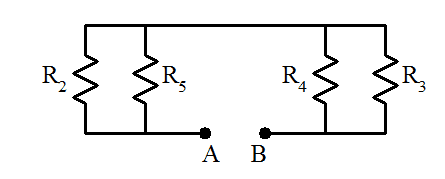

Hi, I understand how R2 ll R5 and R3 ll R4 but what is the reasoning for R2 and R3 being in series and same for R4 and R5? Thanks
  • #48
Redraw the circuit in post #46, suppressing the voltage source (ignoring its small resistance) and placing identified parallel resistances next to each other:
Does that help?

Thanks again for your reply. So, to identify two components are in parallel I can identify that two components share the same pair of nodes. What's the definitive method to determine a component is in series with another? How do I come to the conclusion that they are in series from your diagram? Or are they only considered to be in series once both pair of parallel resistors are added?
  • #50
It's the pairs of parallel resistors that are in series, not the resistors individually. The parallel pairs can both be simplified to single resistance values, and those resistors will be in series (share one node exclusively).
