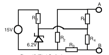

mrowa196

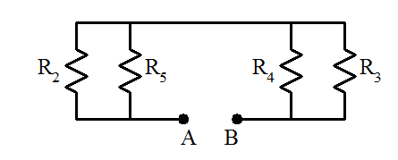

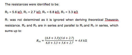

I calculated theoretical value of resistance - I assumed that R4 and R5 are in series and parallel to R2 and R3 which are in series, because I've considered B as the starting point - this is the method I was taught, but I don't know any method of calculating the voltage with the diode. Experimental value of voltage was about 3.75 V.
There's not enough data to arrive at a numerical result. Were you not given component values?

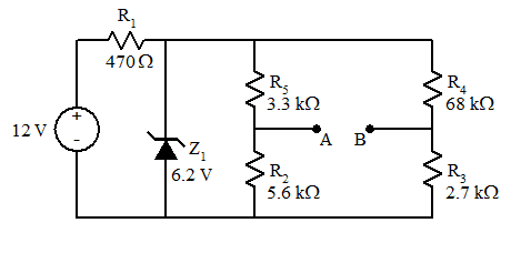

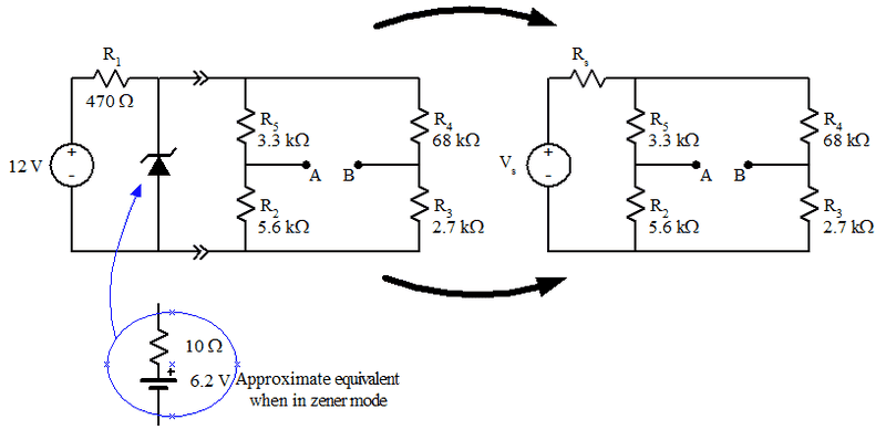

Oh, I am sorry, I thought it was on the diagram:
R2 = 5.6 kΩ, R3 = 2.7 kΩ, R4 = 6.8 kΩ, R5 = 3.3 kΩ
R1 is apparently not necessary.
Suppose R3 and R4 (and, for good measure, point B) were all erased from the drawing, could you calculate the voltage VA with respect to the lower end of the zener?
If I understand the problem correctly, it is asked to find VAB i.e. the Thevenin voltage. Assuming the zener diode is in reverse breakdown region, voltage across it will be 6.2V, fixed. I believe the OP has assumed correct series-parallel combinations. But the voltage value I am getting is not 3.75V, which is obtained experimentally as said. Is there something wrong with the experimental value?
I've also measured the current and calculated experimental resistance and it was 4.64 Ohms, so very close to theoretical value of 4.60 Ohm. Hence, I think it was pretty accurate experiment.

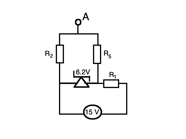

What if I ignored R3 and R4 part of the circuit and I would be left with:
Then I ignore R1 and 15 V source part and I would be just left with 6.2 "source" let's say and two resistors circuit. Then, using voltage dividor rule and the values of resistances of the resistors (5.6/(5.6+3.3))*6.2. That would give 3.9V at point A which is close enough to experimental value, but I just made this method up so I think it's bullshit.

The lab asks that you identify the values for resistors R2 and R4. What was involved in doing that?
Reading from the colour codes. That was checked - they are correct.
Did you also confirm that the other resistors (R3 and R5) actually had the values shown in the lab diagram?
I'm trying to understand how you could have measured 3.75 V across AB given this circuit arrangement. If the zener really is a 6.2 V one, then I'm not seeing a way to achieve this with the given component values.
Yes, I have. The resistances must be correct because theoretical and experimental values of resistances are almost identical.

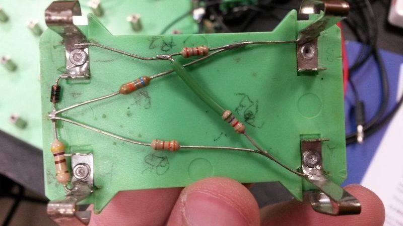

I found the photo of the circuit.
Looking at the photo, I question whether the color code for R4 is Blue-Violet-Red (6.8 k) or Blue-Violet-Orange (68 k). If it's the latter it might explain your measured voltage. It would push it to around 3.8 V.
What short circuit current did you measure?
0.8 mA
mrowa196 said:
0.8 mA
With what supply voltage?
12 V
Okay, with R4 at 68 kΩ I can see you measuring about 3.75 V and 0.8 mA. With those values your Thevenin resistance should be in the kilo-Ohms, not just a few Ohms. So something around 4.7 kΩ.
Yes, you're right, I've actually went through my notes and there is 68000 kΩ written but I've crossed one 0, because I could not get theoretical value of Thevenin resistance close the he experimental one otherwise... Did you get it?

Yes, I can calculate about 4.7 kΩ for the Thevenin resistance, which corresponds nicely with your table values.
Could you please walk me through your calculations?
Then I ignore R1 and 15 V source part and I would be just left with 6.2 "source" let's say and two resistors circuit. Then, using voltage dividor rule and the values of resistances of the resistors (5.6/(5.6+3.3))*6.2. That would give 3.9V at point A which is ...
That's half the working. Then follow a similar procedure to determine VB. Using these results, you can calculate the value for VAB.
The zener is a good voltage source, so replace it with a short circuit.

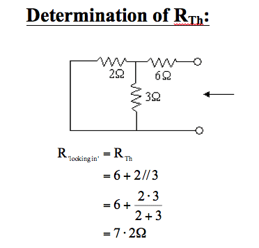

How about the resistance? I've had this:
But despite good result it must be wrong, because it shouldn't be 6.8 but 68 kOhms.
