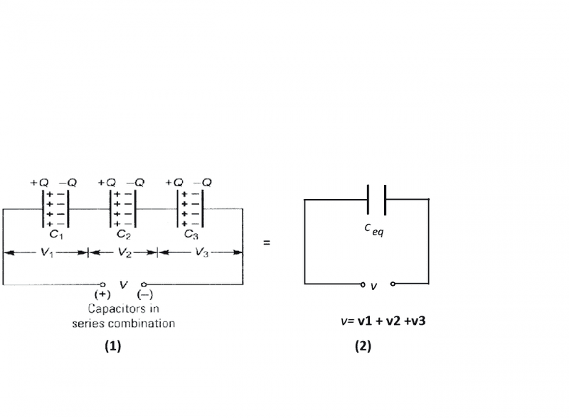

  • #33
gracy said:
To make three pairs of parallel plates capacitors we at least need four plates.
The equivalent capacitors are, of course, in series. You can imagine infinitely thin metal sheets between the layers and then you can treat it in a very straightforward way.

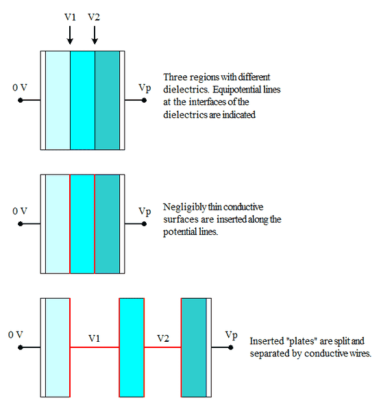

  • #37

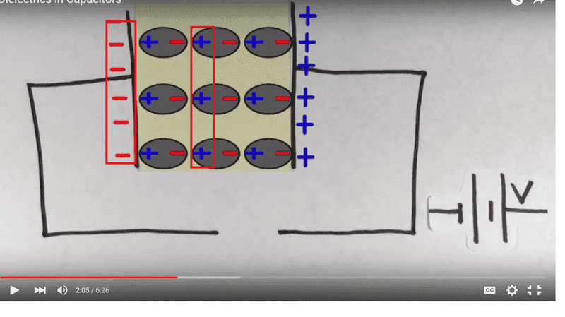

How inserting infinitesimally thin conducting plates at the boundaries of dielectric is same as placing equal and opposite pairs of charges at the same point in space?
I think it has something to do with induced charges in metal plate.
  • #38
The main idea with this is to find a set of capacitors which are easy to analyze and which are equivalent electrically to the capacitor you are given in the problem.
Inserting the plates at the boundaries of the dielectrics will not alter the electric fields in the dielectric materials.
  • #39
Because the field is perpendicular to the boundaries, yes.

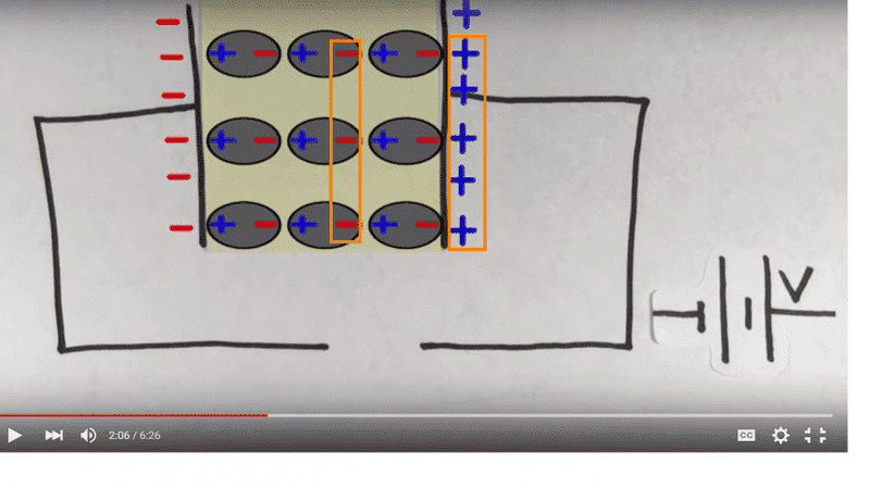

  • #40
And even if it does not alter electric fields in dielectric medium , how we can assume metal plates to be at boundary even though they are not present there?
  • #41
gracy said:

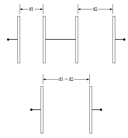

It should be pointed out that the "inserted" plates can be arbitrarily thin and do not change the amount of dielectric involved, nor effect the total size of the regions where the electric field is. The conductive plates assume the potential of the equipotential line where they are inserted and have the same potential on both surfaces. Charge separation ensures that the field is "transmitted" from one face to the other, and it's as though no plate were there as far as the field is concerned on either side of the plate.
You can split such a plate in two and move the halves apart, maintaining a conductive connection with a wire. The potential of the two must remain the same due to being connected, and the field is still "transmitted" from one outer face to the other.
It might be instructive to look at a simpler setup first where there are two capacitors in series and no dielectrics to complicate matters. Both have the same plate area but one has separation d1, the other d2. Use the capacitor equation for parallel plate capacitors and the series connection formula to find the net capacitance. Show that this capacitance is the same as a single capacitor with the same plate area but a separation of d1+d2. This should lend support to the idea that inserting parallel plates and forming series connected capacitors is legitimate.

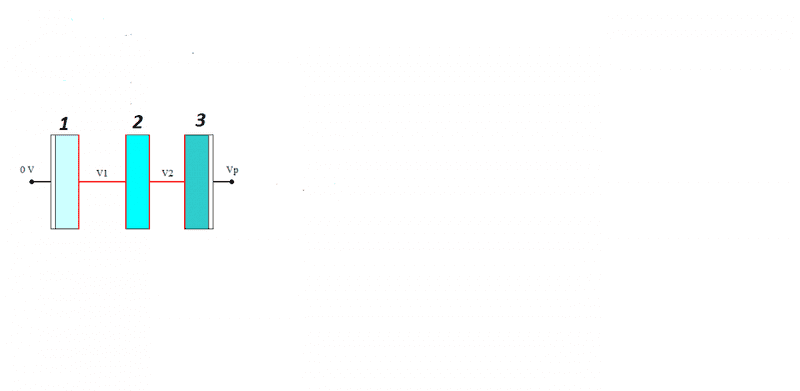

  • #57
You mean if the following two are equivalent
Here also conductive plates have been inserted and inserted plates are split and separated by conductive wires in (1) but it is [picture (1)] is equivalent to picture (2) that means this kind of assumptions are legitimate.
  • #58
Yes. If you combine the middle plates in picture 1, you'll end up with picture 2.

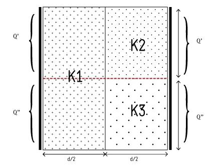

  • #59
I have come to a conclusion
If dielectrics partition the space horizontally , they are in series and if dielectrics partition the space vertically then they are parallel. Correct?
  • #60
Correct, provided that the parallel plates are vertical...and spaced horizontally apart as in the figures in this thread.
