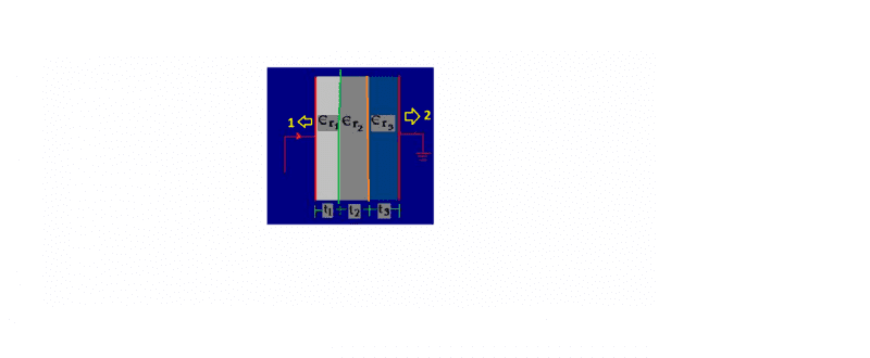

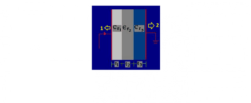

My textbook says this makes three pairs of parallel capacitors.
I don't understand how?To make three pairs of parallel plates capacitors we at least need four plates but here we have only two

You can insert metal plates at the boundaries of two dielectrics. They will be equipotential. Then splitting each plate into two plates in series, you can have 6 plates i.e. 3 capacitors.

Here I have shown green and orange metal plates placed at boundaries of dielectric slab . The left most and the right most plates were already there.

Even if you don't insert plates, still it is a 3 capacitors in series combination.

Do you see that each boundary between the dielectric slabs is an equipotential surface?
No. Is it perpendicular to electric field lines ?

The end plates are conductors and therefore each is equipotential ...

Which ones are equipotential? The end plates (right most and left most plates) or boundaries between the dielectric i.e shown in green and orange color in my post #5? Should be end plates as these are metal plates .

I had said the following:
- hoping that would lead you to further realize -
... therefore, the E-field lines are horizontal (in the picture) so any vertical surface is equipotential, in particular the boundaries between dielectric slabs are equipotential surfaces ...

Boundaries between dielectrics are denoted by green and orange color in my post #5 ,Right?
It looks to me as if that's the case.
If that's where you placed them then, yes, that's correct.
I still don't understand even if these surfaces are equipotential , how can we treat the dielectric boundaries/surfaces as metal plates?

Because of the medium's uniformity and shape, any vertical line you care to draw on your figure will happen to be a line of equipotential, i.e., it joins all points having the same potential because these all have the same path distance to the battery. You can add in a conductor joining points of identical potential and nothing changes---no current flows in a conductor where no potential differences exist.
You started this thread asking how does the figure represent 3 parallel capacitors. It doesn't. Your figure represents 3 capacitors in series.
To show 3 capacitors in parallel, you would arrange the dielectric blocks so every dielectric is in contact with both end plates.
