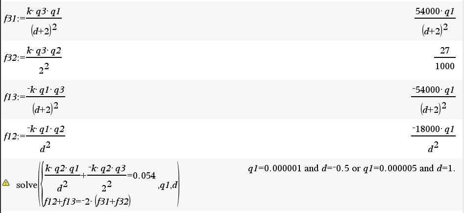

What I did was:
kQ2Q1/d^2 + -kQ2Q3 / 2^2 = 0.054
F1,2+F1,3=-2*(F3,1+F3,2)
Q1= 0.000005 & d =1 or Q1=0.000001 and d = -0.5
Which aren't the right numbers because F2,1 + F2,3 != 0.054

I cannot tell where you are going wrong if you do not show all your steps.
That's how I get it the numbers.
Thank you.
Thank you.
Not sure what tool you are using, but it seems to be giving you a rounding error in the value of q1. It should be 4.5μC.
You don't really need to use such a tool.
You have ##\frac{2q}{d^2}-\frac{2\times 6}{2^2}=\frac{54000}k## where k=9000, and
##\frac{2q}{d^2}+\frac{6q}{(d+2)^2}=2(\frac{6q}{(d+2)^2}+\frac{2\times 6}{2^2})##
This might look messy but it quickly comes down to ##2q=9d^2## and thence ##(d+2)^2=9d^2##
I'm using Ti-Nspire . I will use another calculator.
