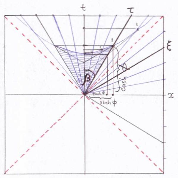

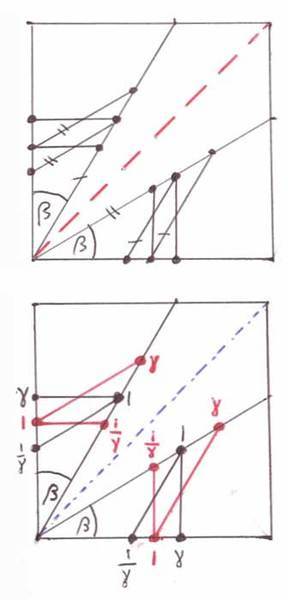

Looks good to me!
The conventional Minkowski spacetime diagram takes a slightly different approach to representing the same information. Here are a couple of examples.
The top diagram in my first attachment, the attachment labelled "parallels", shows which lines are parallel with which. The lower diagram in the same attachment shows the spacetime intervals between the origin and various events (represented by points). As you can see, in this kind of diagram, the intervals aren't exactly represented as the Euclidean distance between points since the hypotenuse of each of those right triangles corresponds to a shorter spacetime interval than the edge that lies along the axis, contrary to what we'd expect from Pythagoras. This is because the equation for the spacetime interval between two events is that of a hyperbola
||\mathbf{E}_{2} - \mathbf{E}_{1}|| = \sqrt[]{|\Delta t^{2} - \Delta x^{2}|}
rather than a circle like the equation that gives the distance between two points in Euclidean space:
||\mathbf{P}_{2} - \mathbf{P}_{1}|| = \sqrt[]{\Delta y^{2} + \Delta x^{2}}
One frame is represented with the vertical time axis and horizontal x axis. The axes of the other frame are inlined towards each other. The faster the frame shown with the inclined axes is traveling relative to the frame shown with orthogonal axes, the closer its axes will be to the dotted line at 45 degrees which represents the path of a photon travelling, of course, at c. The angle \beta represents the speed of either frame relative to the other, as a fraction of the speed of light: v/c.
Any vertical line is the potential worldline of an object at rest in the frame with orthogonal axes; events on those lines happen in the same place in that frame. Any horizontal line is a line of simultaneity in the frame with orthogonal axes; all events on that line will be happen at the same time as each other in that frame.
Similarly, lines parallel to the time axis of the frame with oblique axes represent potential worldlines of objects at rest in the frame with oblique axes; events on those lines happen in the same place in that frame. Lines parallel to the x-axis of the frame with oblique axes are lines of simultaneity in that frame; all events on those lines happen at the same time as each other in that frame.
There's nothing special about either frame. The only difference is that they're moving in opposite directions relative to each other. So we could just as well change our diagram and show the oblique frame with orthogonal axes, and the orthogonal frame with oblique axes. The only difference would be that the axes of our new oblique frame would have a negative slope because its going in the opposite direction to the other frame. So the oblique axes would appear in the 2nd and 4th quadrants, rather than the 1st and 3rd.
My other diagram, the one labelled "hyperbola" is meant to show how this relates to hyperbolic geometry. If we draw a curve through all points on a Minkowski diagram which stand for events with a timelike interval of 1 from the origin, the curve is one branch of a unit hyperbola. Consider one of these events, the one that lies on the axis labelled tau in this diagram. The proper time between the origin and this event is 1. The coordinate time of this interval with respect to the frame represented by the axes labelled here t and x is
\gamma = \frac{1}{\sqrt[]{1 - \beta^{2}}} = cosh\left(\phi \right)
where \phi is the "hyperbolic angle", the input of the hyperbolic trigonometric functions, which corresponds geometrically to the area shaded blue under the hyperbola here. Cosh, sinh and tanh are the hyperbolic cosine, sine and tangent respectively.
sinh\left(\phi \right) = \gamma \beta
and
tanh\left(\phi \right) = \frac{sinh\left(\phi \right)}{cosh\left(\phi \right)} = \beta
so \phi is the value of the inverse hyperbolic tangent of \beta:
\phi = artanh \left(\beta \right)
I gather there are other ways of depicting the Lorentz transformation in two dimensions, but this is the one I'm familiar with, and seems to be the one most commonly used in textbooks. Some more examples here:

The diagram in post 82 may help.
