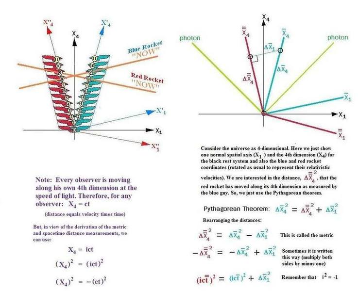

It is interesting to resolve this apparent parodox using a space diagram. Is it possible to attach bmp or jpg pictures as part of a post?
Yes, but png is a better format. You can either upload the picture as an attachment, or upload it to another site and link to it (preferably using img tags).
Thanks. I used to link to a site on the old Kaku forum but didn't know if it worked the same way here. But now that I'm in the reply window I'm noticing the tool list above. By the way, are there any of the old posters from the old Kaku forum around? Has Yuki been around (I think he had just finished his math PhD)?
The image button at the top of the message-editing box is for linking to images that are hosted on other sites.
To upload an image or some other type of file to PF and attach it to your post, scroll down to the "Additional Options" section and click the "Manage Attachments" button.
Got it. Thanks a lot. I notice a significantly increased level of knowledge of Special Relativity in the posts here as compared to the old Kaku forum. Interesting.

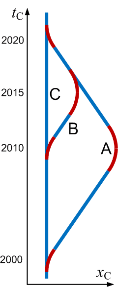

But there is a variation
of the Twin Paradox in which both twins undergo identical accelerations but one takes longer to return and he ends up younger. How do you account for that?

DrGreg made this spacetime diagram for another thread where this was mentioned:
I was thinking of both twins starting off from Earth in separate spaceships accelerating to a final velocity side by side. As soon as they reach final velocity, Twin B turns around and returns to Earth but Twin A doesn't turn around until some time later. They both experience exactly the same accelerations, just at different times for the return trip. Twin A will be younger after they reunite.

What he's describing is just DrGreg's diagram turned upside down (just the curves, not the axes), or equivalently, the smaller bulge moved down so that it touches the bigger one at the bottom instead of at the top. The proper times of these two curves are clearly not the same.
Turn the diagram in post #16 upside down and shorten the blue (inertial) segments in B's worldline to zero.
(However, PAllen gave a different example in #15. Both examples are valid but I think ghwellsjr's is easier to understand.)

It's not the accelerations, it's the comparative 4-D distances travelled. More precisely, it's the difference in the length of the world lines from the 4-D point of separation and the 4-D point of later intersection. Each one moves along his own world line at the same 4-D speed, i.e., the speed of light, c.
Upon a little reflection, one might ask, "What is actually moving? I mean, if the travelers are actually 4-D structures in a 4-D universe, then those 4-D structures (the travelers) are static, i.e., no motion at all as 4-D structures. So, who is doing the moving?"

It seems like DrGreg's space-time diagram presents the situation in the most fundamental way. The world lines tell the story--the mathematical details and talk of accelerations just detracts from the fundamental simplicity of DrGreg's diagram.

The thing I like about DrGreg's space-time diagram is that it presents a fundamental picture from which the various Special Relativity effects can be reasoned. When beginning with space-time diagrams it might be useful to sketch the situation we see in the above left sketch where blue and red rockets are moving away from each other with respect to a "rest" refererence frame (the black coordinates, X1 and X4). Consider the rockets and the occupants to be 4-dimensional static structures (they don't actually move). But, at any instant of time, the normal 3-dimensional laws of physics are observed in a 3-D cross-section of the universe that is different for the red and blue rockets. The slanted lines indicate the two different instantaneous 3-D universes. You can see that when the blue guy is at station no. 9, his 3-D universe intersects the red rocket at station no. 8, a time much earlier than his own. And when the red guy is at station 9, his universe intersects the blue guy's rocket at blue's station no. 8, again a much ealier time than his own. A symmetric setup like this always allows you to develop the time dilation equation pretty easily just using high school algebra (my physics professor used to explain to us how the ancient Greeks could have discovered Special Relativity).
The world line (4th dimension) for observers moving at various speeds relative to some rest frame have different slants. But, the world line of a photon always bisects the angle between any observer's X1 (a normal spatial dimension) and X4 (time) axis.
Once you get the knack of the space-time diagrams you can unravel tricky problems as demonstrated so nicely by DrGreg.
