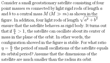

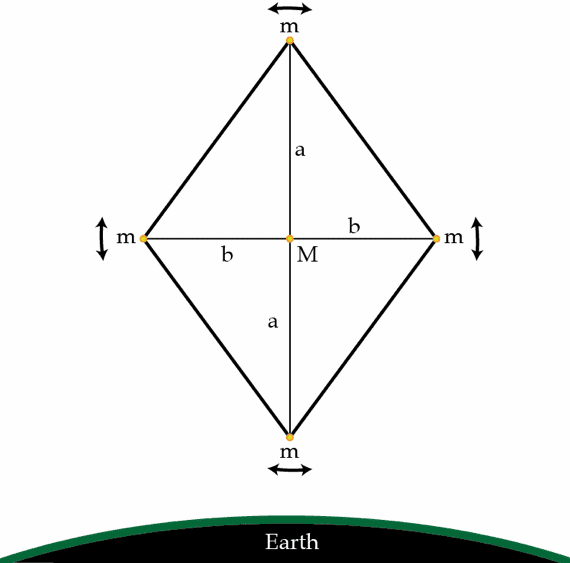

The discussion revolves around solving a problem involving the oscillation of four point masses under gravitational influence. Participants suggest starting with the potential energy of the system and incorporating kinetic energy for small oscillations, emphasizing the harmonic oscillator model. They discuss using Taylor expansion and approximations to simplify calculations, particularly for potential energy and its derivatives. The conversation also touches on the relationship between angular displacement and velocity, highlighting the need to express kinetic energy in terms of angular motion. Ultimately, the goal is to derive the period of oscillation and understand the dynamics of the system's energy conservation.
Saitama
4,244
93
I really don't know how to start with this problem. The four point masses of mass m oscillate together so I am confused as to how should I begin making the equations. Just a guess, should I write down the expression for potential energy of the system?
Any help is appreciated. Thanks!
Sure. Add the kinetic energy for the mentioned oscillation afterwards.
This is just a harmonic oscillator (for small excitations).

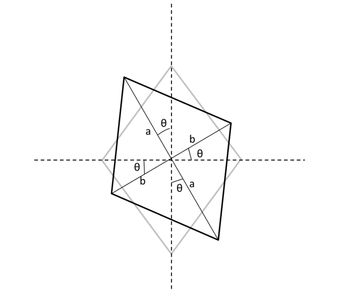

Please see the attachment.
U_i=\frac{GM_em}{R-a}+\frac{GM_em}{R+a}+\frac{2GM_em}{R}+C
where C is the potential energy of central mass with respect to Earth and the potential energy of point masses with respect to each other and the central mass.
U_f=\frac{GM_em}{R-a\cos\theta}+\frac{GM_em}{R+a\cos\theta}+\frac{GM_em}{R-b\sin\theta}+\frac{GM_em}{R+b\sin\theta}+C
I am thinking of using the following approximations:
\frac{1}{R-a}=\frac{1}{R}\left(1+\frac{a}{R}\right)
and
\frac{1}{R-a\cos\theta}=\frac{1}{R}\left(1+\frac{a\cos\theta}{R}\right)
Should I replace ##\cos\theta## with ##1-\theta^2/2## for small angle approximation?
How to find the kinetic energy? Do I have to work in the frame of CM? Is it simply ##2mv^2## where v is the velocity of each point mass?

Your approximation should work, but, personally, I would just find the second derivative with regard to the angle directly, and form ##k\theta^2## as the potential energy due to the small displacement. That should eliminate any concerns about the validity of approximations.
Regarding the kinetic energy, we only care about the motion due to the small displacement, which makes CM the frame of choice.

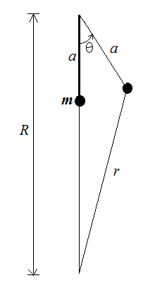

Likes 2 people
  • #38
TSny said:
You will need to be more accurate in the initial expressions for the distances from the center of the Earth to the masses ##m## as functions of ##\theta##. You have to be careful that you are accurate to ##\theta ^2## in ##U##. The law of cosines might be helpful. See the figure for the bottom mass ##m##.
Great, thanks a lot TSny! :smile:
I thought that calculating the second derivatives would be a mess because it would involve surds in the denominator but really, it wasn't because the approximations worked fine and there was no need to calculate the derivatives.
Here's what I did:
Number the particles starting from the bottom one and going clockwise. From cosine rule,
$$r_1^2=a^2+R^2-2aR\cos\theta \Rightarrow \frac{1}{r_1}=\cfrac{1}{R\sqrt{1+\cfrac{a^2}{R^2}-\frac{2a}{R}\cos\theta}}$$
Using the approximation,
$$\frac{1}{1-2x\cos\theta+x^2} \approx 1+x\cos\theta+\frac{3\cos(2\theta)+1}{4}x^2$$
##1/r_1## can be simplified to
$$\frac{1}{r_1}=\frac{1}{R}\left(1+\frac{a}{R} \cos \theta+\frac{3\cos(2\theta)+1}{4}\frac{a^2}{R^2}\right)$$
Similarly,
\frac{1}{r_2}=\frac{1}{R}\left(1+\frac{b}{R}\sin\theta+\frac{1-3\cos(2\theta)}{4}\frac{b^2}{R^2}\right)
\frac{1}{r_3}=\frac{1}{R}\left(1-\frac{a}{R}\cos\theta+\frac{3\cos(2\theta)+1}{4}\frac{a^2}{R^2}\right)
\frac{1}{r_4}=\frac{1}{R}\left(1-\frac{b}{R}\sin\theta+\frac{1-3\cos(2\theta)}{4}\frac{b^2}{R^2}\right)
Potential energy U is:
U=-\frac{GM_em}{r_1}-\frac{GM_em}{r_2}-\frac{GM_em}{r_3}-\frac{GM_em}{r_4}+C
where C is a constant comprising of potential energy of central mass wrt Earth and of point masses wrt each other and the central mass.
Substituting the expressions,
U=-\frac{GM_em}{R}\left(4+\frac{3\cos(2\theta)+1}{2}\frac{a^2}{R^2}+\frac{1-3\cos(2\theta)}{2}\frac{b^2}{R^2}\right)+C
\Rightarrow U=-\frac{GM_em}{R}\left(4+\frac{a^2}{2R^2}+\frac{b^2}{2R^2}+\frac{3\cos(2\theta)}{2R^2}(a^2-b^2)\right)+C
Since ##\theta## is small, ##\cos2\theta \approx 1-2\theta^2##.
\Rightarrow U=-\frac{GM_em}{R}\left(k'-\frac{3}{R^2}(a^2-b^2)\theta^2\right)+C
where k' replaces the constant terms inside the parentheses.
Kinetic energy K is
$$K=m(a^2+b^2)\dot{\theta}^2$$
Hence,
$$E=-\frac{GM_em}{R}\left(k'-\frac{3}{R^2}(a^2-b^2)\theta^2\right)+C+m(a^2+b^2)\dot{\theta}^2$$
$$\frac{dE}{dt}=\frac{3GM_em}{R^3}(a^2-b^2)(2\theta\dot{\theta})+m(a^2+b^2)(2\dot{\theta}\ddot{\theta})=0$$
Simplifying,
$$\ddot{\theta}=-\frac{3GM_em(a^2-b^2)}{R^3(a^2+b^2)}\theta$$
Therefore, the time period of small oscillations is
$$T=2\pi\sqrt{\frac{R^3(a^2+b^2)}{3GM_em(a^2-b^2)}}=2\pi\sqrt{\frac{R^3(\eta^2+1)}{3GM_em(\eta^2-1)}}$$
This is equal to ##2\pi\sqrt{R^3/(GM_e)}##. Equating,
$$\frac{\eta^2+1}{3(\eta^2-1)}=1$$
Solving for ##\eta##,
$$\eta=\sqrt{2}$$
This is the correct answer. Thanks a lot everyone. :)
